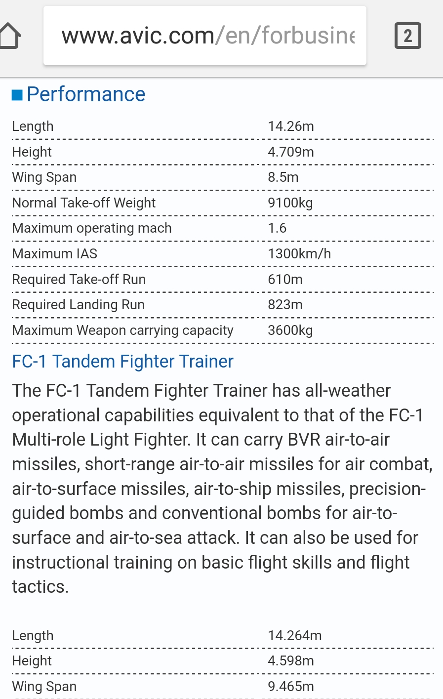

"Version B has low wing loading compared to standard ver "
What does the above statement signify in layman's terms?
[QUOT
Either larger wing surface area, or lower weight, or both.

The PAF will order some JF-17 Block-IIs on top of the 50 it originally intended. This is to bridge the production gap from the 50th Block-II and 1st Block-III. It's possible that these follow-on fighters will be JF-17B.
The lower the wing loading, the better the maneuverability and shorter the landing and take-off distances.
