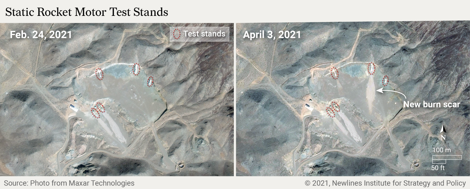

God daaaaamn, breaking news: Iran has succeeded in testing ICBM solid fuel engine
Around mid-March, a large burn scar appeared in the rocket motor test stand area. This was the first time Iranian engineers had made use of this test stand, the largest of the four in the area, indicating that they have reached a milestone in terms of the size of the motors.
1) according to Fabian Hintz, Test Stand 4 has a thrust between 164-246 tons
2) according to Uzi Rubin's article "Iran’s winged horse rocket: Another step towards global reach", Sarir is a "a giant three-stage solid-propellant SLV with an estimated take-off weight of almost 160 tons"
3) So we can assume that engine from Test Stand 4 is an engine for Sarir, which is a giant solid fuel SLV
