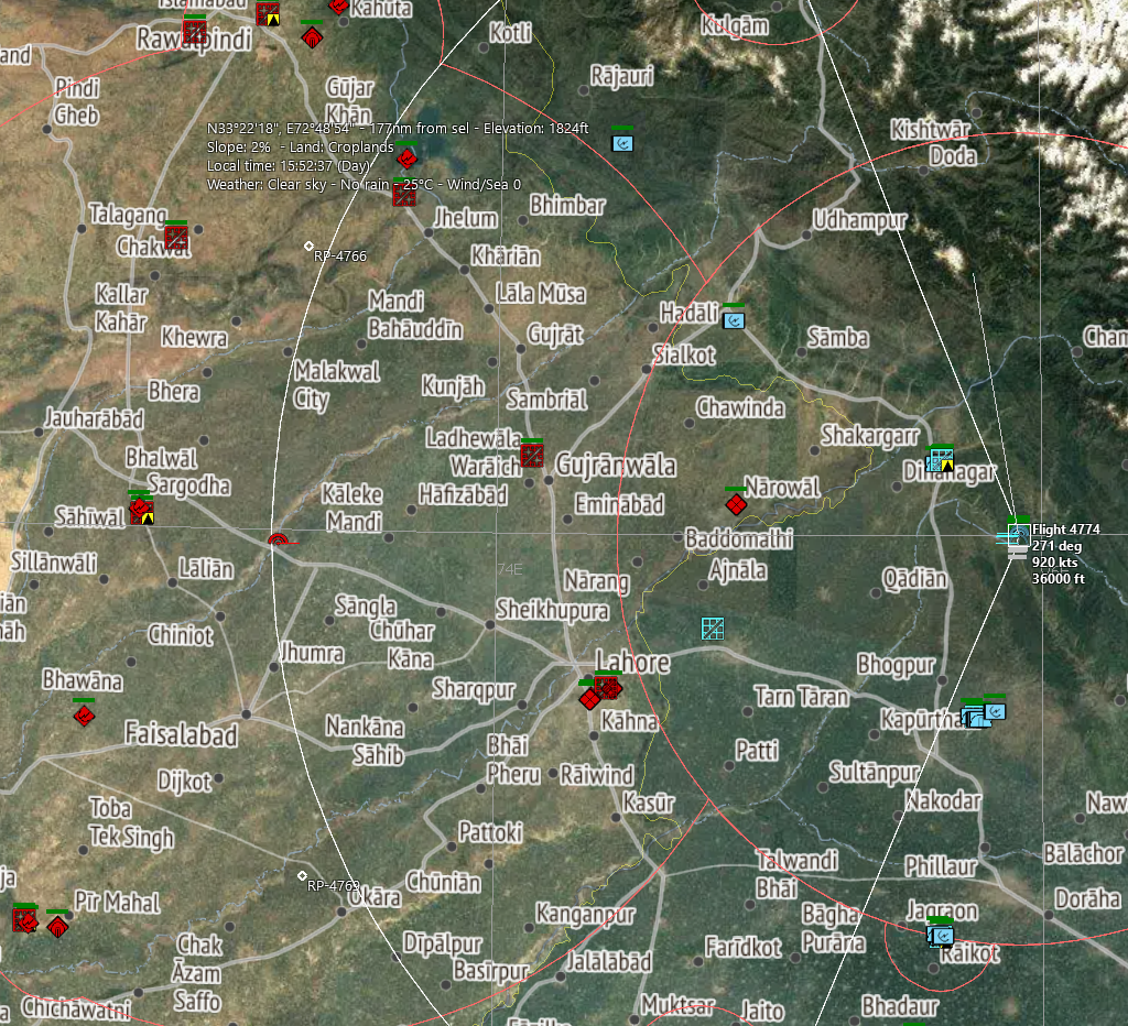

Can you run this scenario, please?

Just one question, why does that J-10 suddenly notch when it has a greater detection range? Since a notch is performed well below the max detection range, I would imagine that value wouldnt factor into ability or decision to notch.
The notching is to maintain a lock at the edge of the gimbal to guide the missle as much as possible before it goes active. My guess is there is a little bit of database “bias” in terms of how the Radar performance is interpreted as both the block-3 and J-10 should start notching as soon as they launch.
Great job - if you dont mind me asking - what did you use to run the simulation? DCS?

They are all there - this is Command

Max Range of PL-15 is simulated at 92nm while the Meteor is at 75nm.
Sir, Max range of PL-15E has been revealed to be 145km or around 78nm in an official brochure.
Please reduce that in the simulation.
