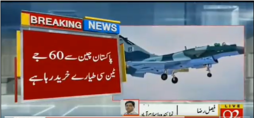

Hearing news that the order has been increased from. 36 to 60
Pakistan purchasing 60 J-10C....
60 means 4 squadrons, 15 birds each.
If it comes to fruition, then which other base would house the additional birds?? All 60 can't be stuffed at Kamra...I believe Rajanpur is ideally placed, dead center of Pakistan, to be made an operational base, and house J-10s.
Are there not 18 fighters in a PAF squadron?
Yes. Ideally 18 airframes per sqn. But sometimes there are variances. No 2 sqn was expanded to have more aircraft due to its expanded area of ops incl. maritime duties.
Except for housing and maintenance hangers, Rajanpur has all the infrastructure for an operational base including underground command and control center.
