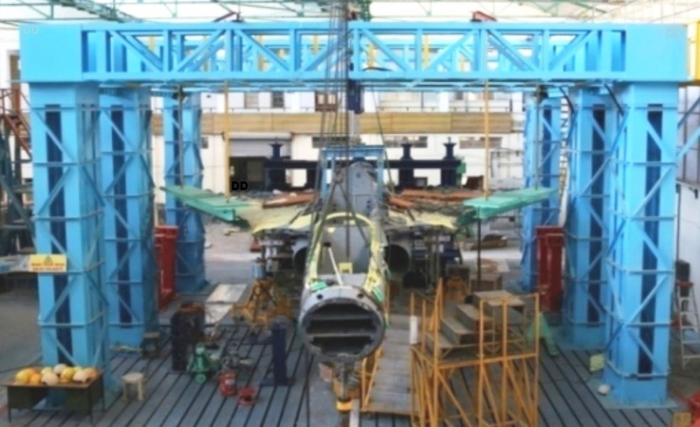

There were system integration problems, indeed. But I don't know that anyone ever said, even CAG about QA/QC for Tejas. More so they going for 6000 and 10000 hours of stress tests for certifying the airframe, if there is such problems, they won't be going for such stress tests.
I never heard of this,, even from the worst critique, actually all praise about this aspect. Can you post some material about it?
I cannot - my source is here on the forum and a colleague from my UK Post graduate studies.
QA issues in parts delivered to HAL.
