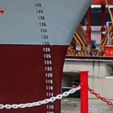

There is someone make calculations based on photos of Draft CVBG-18
12-13 meters of draft and 80,000 tons of full displacement?
Wait, the official Chinese media say it is more than 80,000 tons.
“300*40*12.5*0.6*1.025=92,250="80,000+"
Well, they are right.
Full-load Displacement probably in the range of 92,000 Tonnes

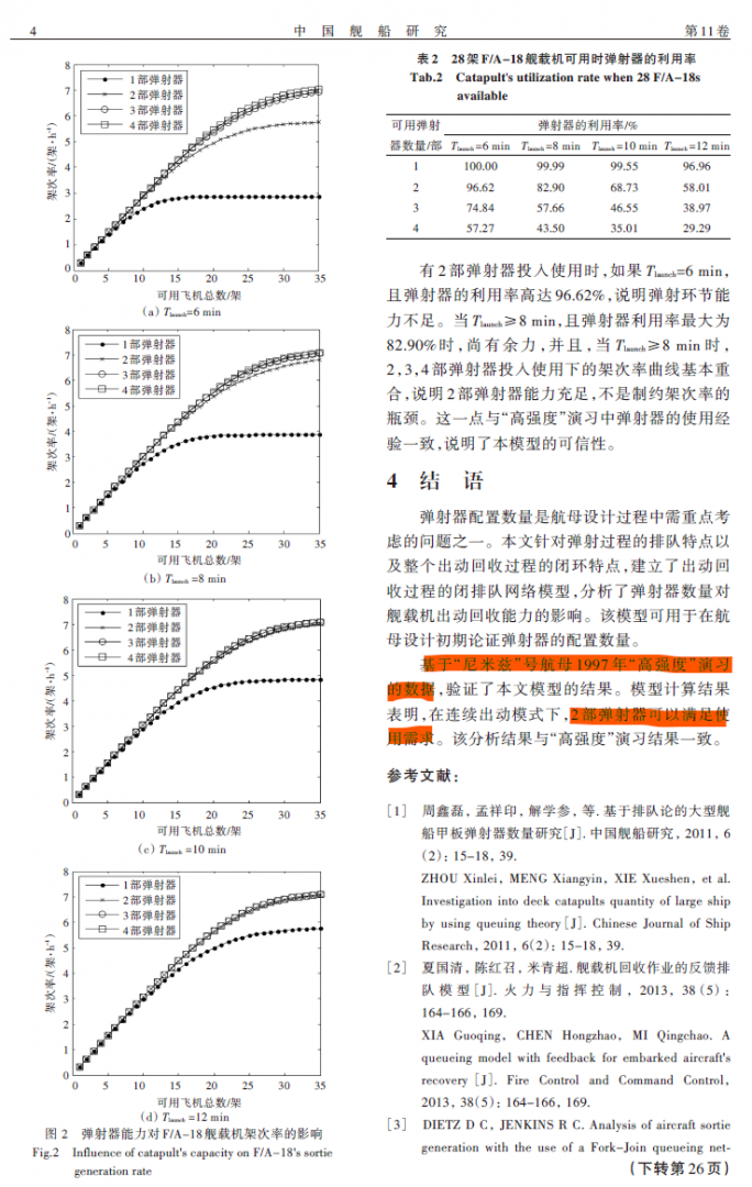

Regarding the number of catapult on 003 being 3 instead of 4 as USN, here is a research paper from 2016 by China Ship Development and Design Center. Title "基于闭排队网络的弹射器数量配置方法"/"Method of the catapult quantity deployed by using closed queuing network"
Here is the conclusion,
Based on data from Nimitz 1917 high tempo exercise, the research concludes that 2 catapults are enough.
From table 2 and the diagrams, it can be seen that only when T_launch=6min, 2 catapults will be close to 100% used which is too much. In all other cases, there is enough margins. This means 2 is the minimum and runs some risk of overloading the catapult. 3 is as good as 4. 4's redundancy advantage then 3 is visible but insignificant.
Next aircraft carrier will be still 3 catapult and 2 elevator. There are simply too many fabricated news floating around try to misled reader thinking China Fujian aircraft carrier got some deficiency with 2 elevator and 3 catapults.
