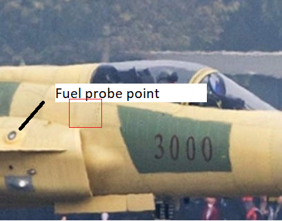

Only on Block-III and permanent air intake in attached picture.
There is a lot of room for newer installations. These placements will appear by the time when we see clear pictures. Previously these two points on each side were allocated for MAWS but now being shifted to upper location. New sensors are in as they suits.

This is the directional light. Probe will be near cockpit. As highlighted in red.
Actually when will the fuel probes be fitted?
Probes will be installed per requirements on particular aircrafts. However, the option exists on all airframes post 229 Block-II. Installing Refueling Probe on Thunder is now a matter of minutes I believe if not an hour.
I would have thought this would be standard install. This would help keep aircraft in the air longer.
Installing the probe takes minutes.

Minutes may be an exaggeration unless all the internal piping is done. Then minutes is probably right. Maybe 300 minutes to 400 minutes loool
Don't be so negative on everything. Read the earlier post where I said, Minutes and if not an hour which makes it less than one hour = 60 minutes. Secondly, internal plumbing is done on all the frames and it takes double digit minutes to install probe externally.
Bhai...I think u are forgetting I am an aerospace engineer with a masters in aircraft design from cornfield. I worked for BEA and Ricardo as well the DRAE Farnborough. I know how long things take...60 60minutes to fit an aerial refueling probe is almost impossible. Unless ofcourse you know better. Also course mate does exactly this at a Cambridge based company that specialises in aerial refuelling probes.
I am not negative...I know it can be done quickly but under an hour. I question that. Have a nice day
Re-tractable V/s fixed probe, might be the subject for difference in installation time. What I got on Thunder, is like more than single source.
@Trango Towers
If the panel is riveted then it is days job. If panel is fixed with fastners and the probe comes embeded in panel, then it will be fixed with the fastners within an hour.
The vibration normally won't allow fasnters in aviation. There are some techniques which keep the screws in places (like O spring). However, not a good method.
I also believe that it shd be riveted so that will take 1-2 days at least, with few cycles of panel life.
I presumes all the pipe work is already installed on each thunder and only the probe will be required to be attached
@Trango Towers
