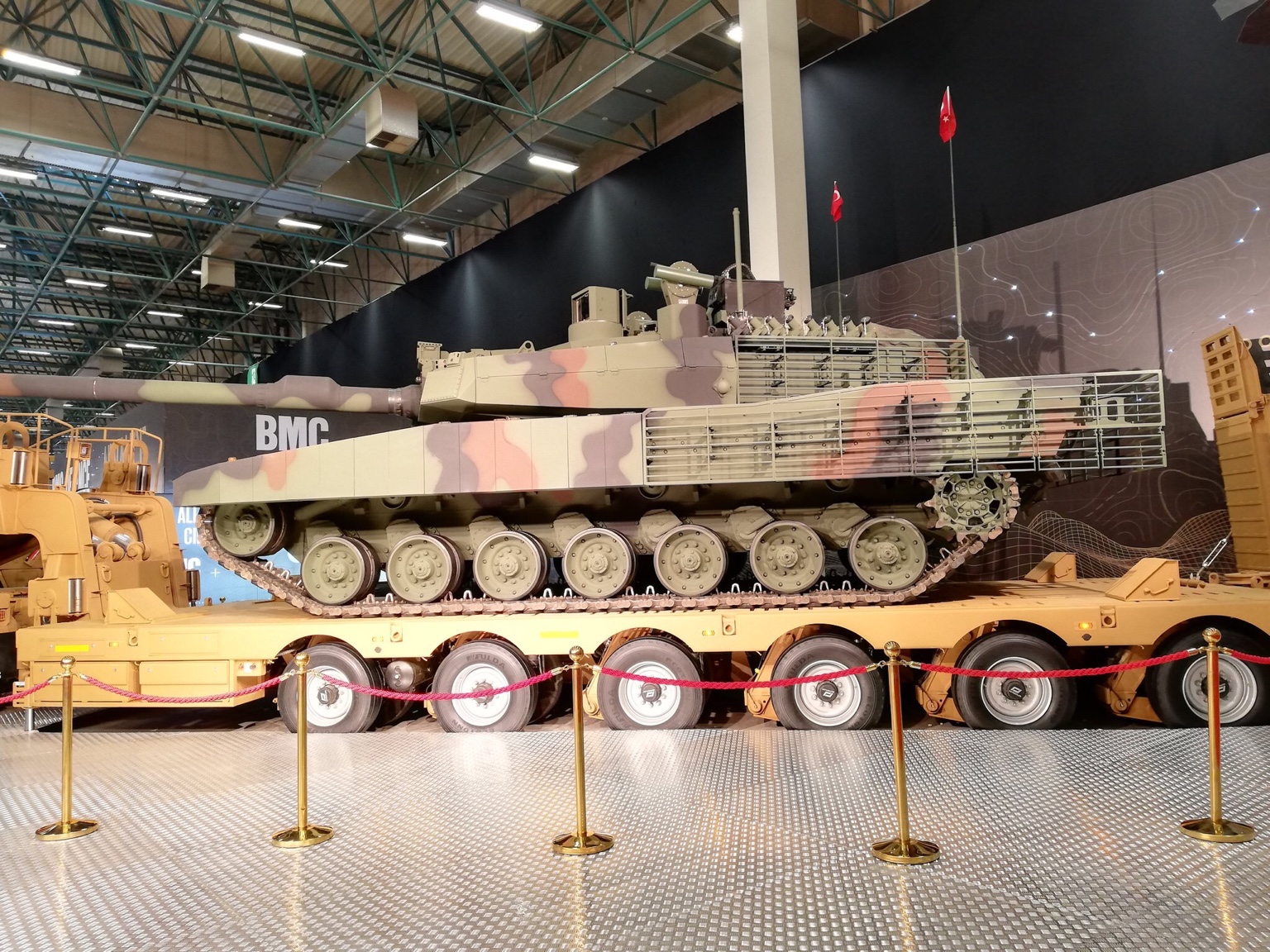

In April 2018 the Turkish Defense Industry Presidency (SSB) announced that the production contract for the new Altay main battle tank was to be assigned to BMC, however the actual contract was signed only in November 2018, and six months later the prototype of the production tank is starring at IDEF on board a new tank transporter.
The contract calls for the production of 250 MBTs, which however will not be all at the same standard. The one seen at the Istanbul exhibition is in the so-called T1configuration, which has some improvements compared to the development prototypes. The main differences are quite visible as they come in the form of a new explosive reactive armour, developed by Roketsan, installed in the front half of the hull side, the rear one being fitted with a BMC-developed cage armour, said to defeat 75% of RPG-like projectiles.
Both the ERA and the cage have the same width. The other main add-on is also aimed at increasing protection: that is the Akkor active defence system, developed by Aselsan, which radar antennas are installed at the corners of the turret, while the two twin launchers are installed right and left of the remotely controlled weapon station fitted on the turret roof, in order to ensure 360° coverage. Laser warning receivers have been integrated within the active protection system increasing its efficiency. BMC will provide the Turkish land Forces with 40 tanks at the T1 standard, all powered by an MTU 1,500 hp engine. These will be produced at Sakarya. In fact the T1 tanks will be 41, a first tank defined as “promotion” to be completed in the 18th month after the signature of the contract, which means May 2020. Six months later the first production Altay T1 should be delivered, the production of all 40 to be completed by February 2022.

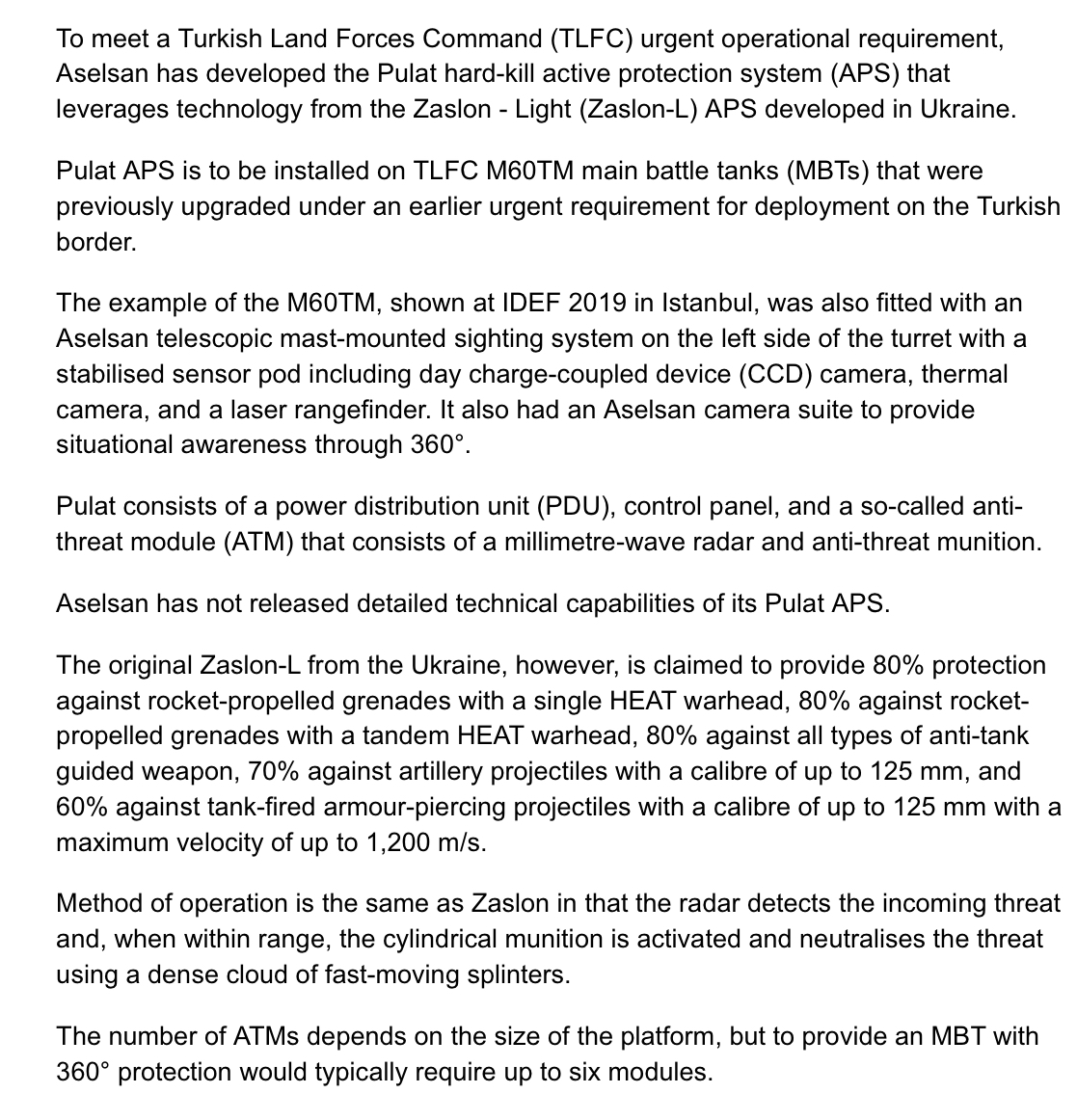

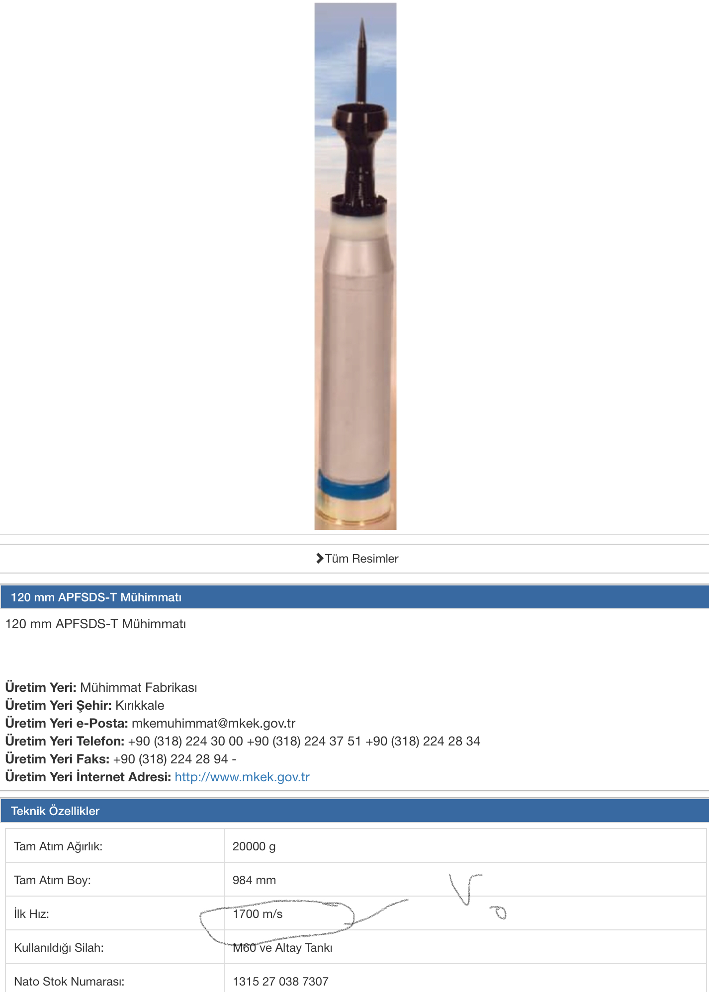

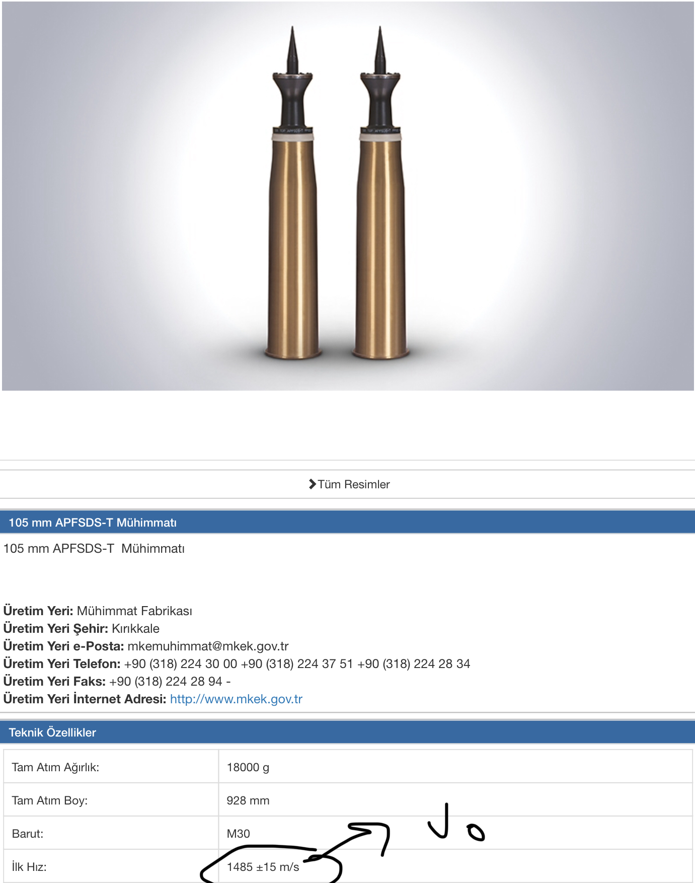

We can assume that 1700m/sn can not maintained at far distances but we do not know exact projectile so is pulat can prevent an open question
The fired projectile has that speeds at the time of barrel exit. Naturally it will loose its speed due to air friction. So the question is what the speed of projective when it reached to its target. If its more than 1200 mps, then APS will fail, it is less than that not.
