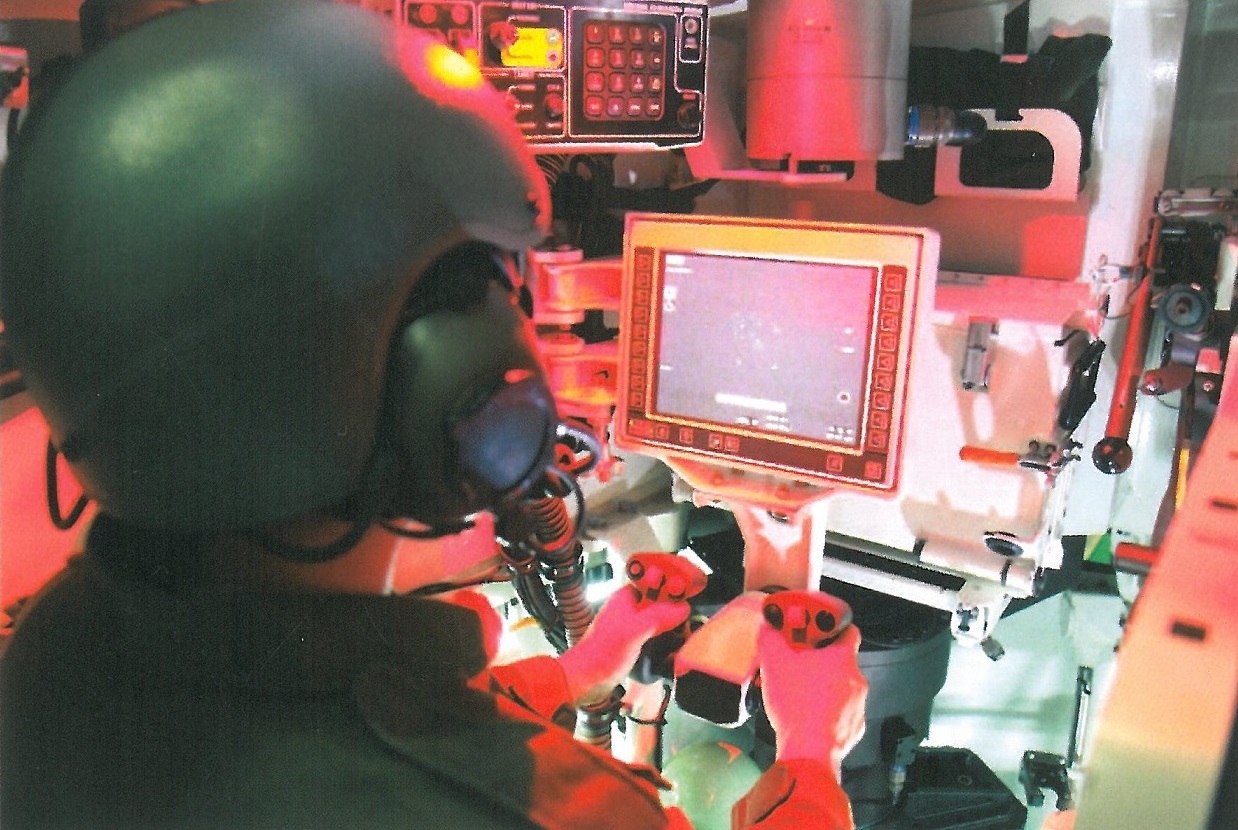

ALTAY MBT Remote Controlled SARP turret control panel...
Thx Cabatli...
:D Bro, that's from the Otokar magazine you got scanned :)
