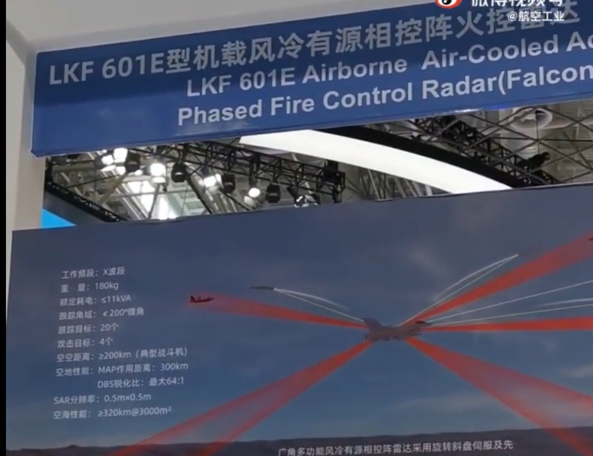

Range of KLJ-7A is 170KM against fighter sized target. Damn.
New air-cooled LKJ-601E had improved it to more than 200KM against typical fighter,i think as a winner of the competing liquid-cooled KJL-7A should do better.
The article says it has improved 65% over the prototype radar that had 81NM range. That comes out around 250Km.
By prototype couldn't it have meant the radar on the prototype JF-17 i.e. the mechanically steered KLJ-7v1? And the more than 81NM range stated in the article is for the current one i.e. KLJ-7A?
Also, this could be the open market export version specs. Because why should we reveal what prowess our own Thunders would be having in the context of radar ranges?
KLJ-7v1/2 have already been marketed at around 110km for 5 sq m RCS target if I remember correctly so how would 81 NM (150Km) be 65% more? Also if we refer to the updated specs of LKF601, it’s now touted to be 200Km.
In any case this article has created some confusions and @SQ8 is just refusing to answer my queries to clear things for us:-)
