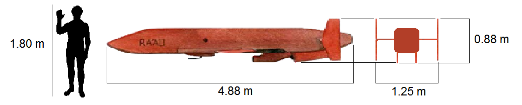

The Ra’ad is a significantly large missile. The following drawing has been made after many pixel-counting exercises and is a good ballpark estimate of its size.
DISCLAIMER: Pixel counting by its nature is inaccurate and these numbers could be off by up to 10%. Nonetheless these numbers give us valuable insight which we previously lacked.

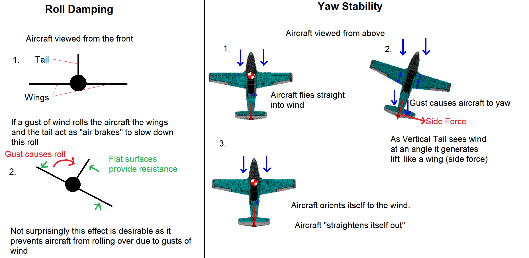

Roll Damping

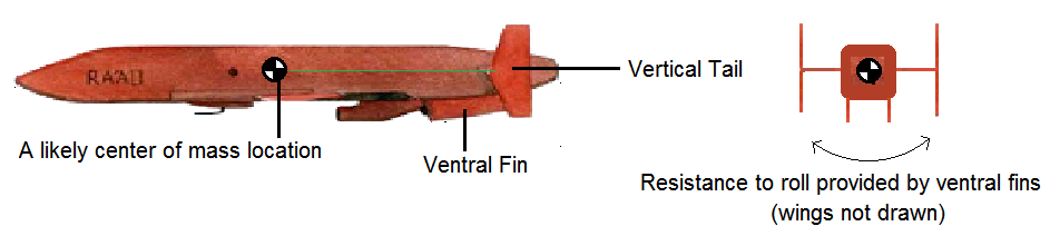

As one would imagine the heavier the aircraft the more tail and wing area is required for “enough” positive stability. The Ra’ad is a heavy aircraft with very small wings so roll damping is small. This would mean for enough roll damping the designers have to compensate with more tail area in the form of ventral fins. The farther away they are from the center of mass of the missile the better they will perform as they produce more moment for the same area. It is for this reason they extend below the fuselage (in contrast to the vertical tail that are in line with the fuselage).
As the above image illustrates the vertical tail adds little or no roll damping and it is for this reason two ventral fins are there (among other reasons).
Yaw Stability
Yaw stability is provided by the vertical tails. It is evident that because of the mass of the missile a large vertical tail area is needed which is provided by two vertical tails.

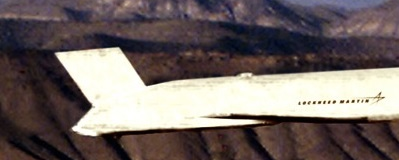

The JASSM on the other hand employs one rather large vertical tail.
