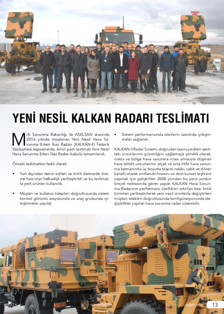

Kalkan-II radar delivered !
Fabulous news. X band Radar with 120km range is ready.
