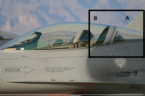

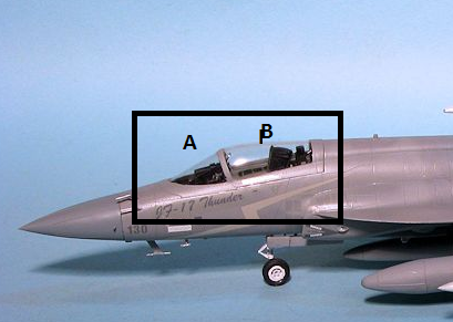

F16 Canopy is also two piece and with clever piece of Engineering its the opposite on any fighter we see e.g
Part A will be at front e.g
and for many other fighters ,F16 comes with a bird slicer at front if im correct ,Any one care to explain what's the limitation for putting B part at front

Stress fracture---distortion---flexing. That is why you see the same setup on the J20---.
With the available technology---for the JF 17 that is the best setup---.
Just loo at this---how big the canopy is on the F16 dual seater.
