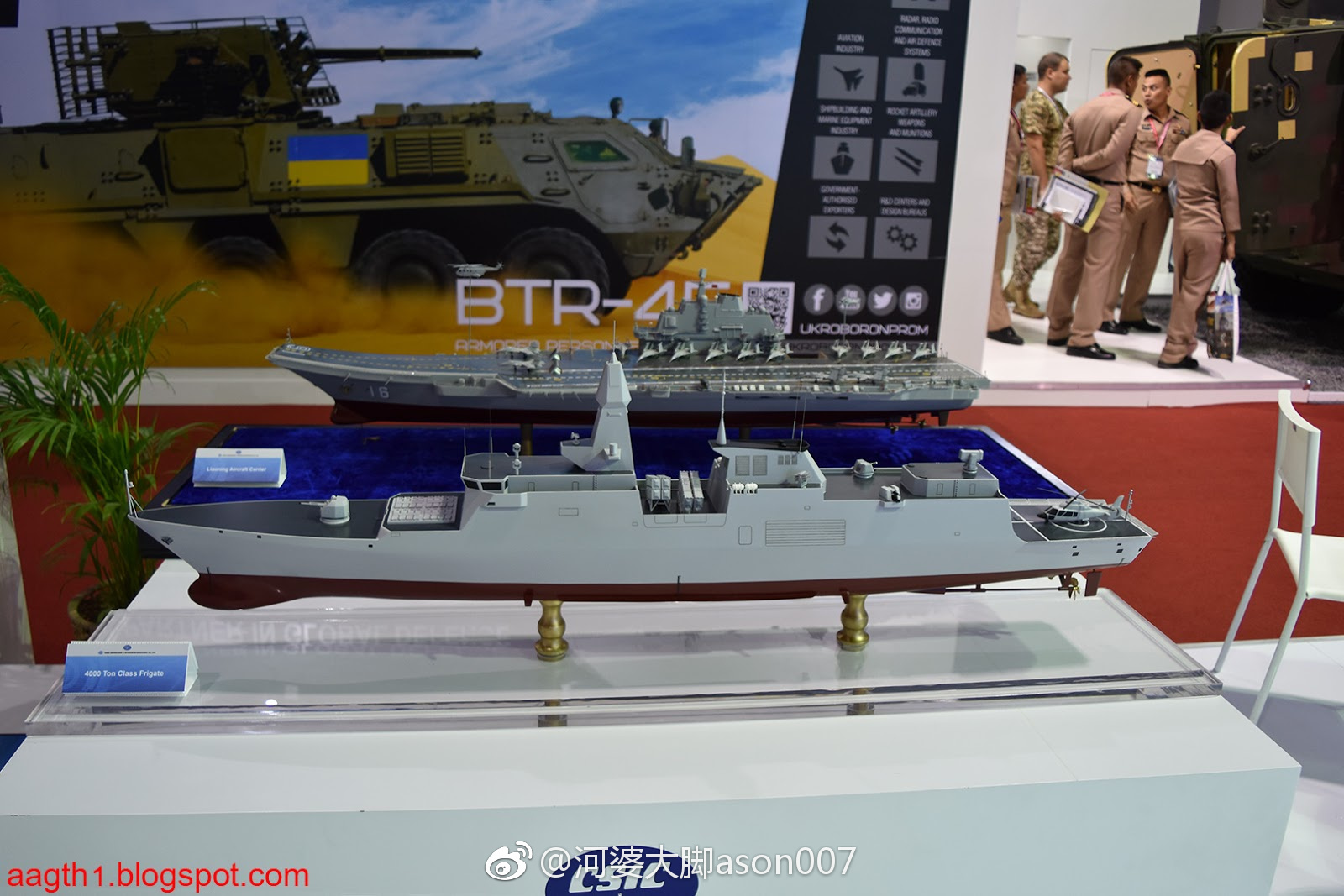

based of the type 057 thats was modelled in pakistan last year
pics from your site

The CSOC 4,000-ton frigate (for export) is based on the Type 054A. There are some differences, e.g. there's a model without a target-illuminator and longer VLS, but at their core, same ship as the Type 054A.

The model at IDEAS didn't have FCR for SARH missiles (LY-80N) though one could be fitted with the actual ship. 70 km range LY-80N shouldn't be far off.
Assuming that each ship costs 350 million USD, that is 1.4 bn USD for four. The LR-SAM capability it could bring will be worth every penny spent.
Fleet level AD for F-22P, Alamgir, remaining Type 21 and possibly Ada corvettes as well.
If they can at least get the 280 km APAR and 500 km OTOH, the Navy would have (1) the ability to guide the CM-302 or CX-1 AShM and (2) provide stand-off range surveillance in lieu of and/or complementing AEW&C. Of course, with the sensor suite in place they can fit LR-SAM later.
