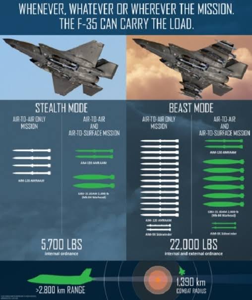

A question @Deino
F-35 can carry 14 BVR missiles
F-15 can carry 14 BVR missiles
F/A-18 super Hornet can carry 10 BVRs
F/A-18 Hornet can carry 8 BVRs
How many J-10 can carry only 4 ?View attachment 821310

I don’t see the practicality of carrying full load during air superiority mission.
Kindly look at the pictogram shared . It shows 10 bvrs .In theory yes, but I must admit, I haven't see any J-10 carrying any AAm on the inner station.
It seems, the mosta realistic load is 6
Not sure how to come to 12. Only the other wing stations are wired for PL-10, the center wing stations for 4 AAMs on twin-launcher and again, the inner wing stations have never been seen carrying AAMs. And please forget the fuselage hardpoints, they cannot carry AAMs.
As such the number is 6, not less but also not more.

Yes 6 at most. The inner pylons are for dumb bombs. Not really sure why there is a need for more aam pylons since shooting down 1 or 2 aircraft would be pretty good showing per sortie. Adding more missiles will simply reduce loiter time and increase rcs.In theory yes, but I must admit, I haven't see any J-10 carrying any AAm on the inner station.

It may not but its maneouverability will be affected badly. The ideal loadout for A2A is/4+2. If you have a twin engine 6+2. No one is going to carry more in the Indo Pak arena. The F15 s carrying a full loadout was a testament to its strength plus how it was used for battles.So in full load out it can carry 6 MRAAM (PL-12/PL-15) missiles, and 2 PL-10s under the wing. And an under belly centerline fuel tank. EW and targeting pods at chin mounted hard points and a couple of ground strike guided bombs in the back! Am I right?? Or would it exceed it's maximum take off weight!
There are no 10 bvrs. And I'm not sure about changing pylons for more BVR missiles part. Only stated by the guy who made this diagram. Right now all we see is 4X PL-15 and 2X PL10 max for J-10C.Kindly look at the pictogram shared . It shows 10 bvrs .
