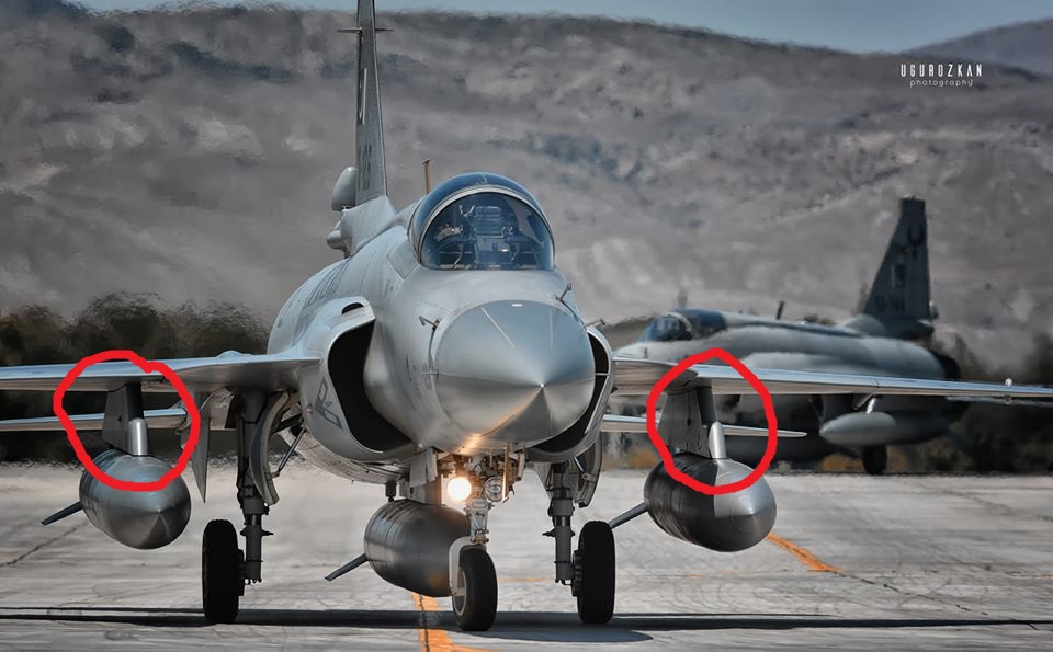

would it not make sense to come up with some kind of extendable pylon
Extendable means you need a mechanism (hydraulics may be) there which means more strong wing, means more weight ... also, with tank closer to wing, will deprive that area of incoming wind, and thus it effectiveness.. so that portion will not contribute to lift. so lift supersedes drag :P
More along the lines of this danger
that is very valid

My question is to the professional real fighter pilots and aeronautical engineers.
Would it not reduce the drag if the pylon height was reduced to hang the stuff closer to the wing?
Is the pylon height kept so much to reduce the risk of the payload tipping up and hitting the plane when they are released?
If the above two points are correct, would it not make sense to come up with some kind of extendable pylon to keep stuff closer during regular flight and extend it when releasing the payload?
@Bilal Khan 777 @Ark_Angel @airomerix @gambit
SSS: Safe Store Separation. The Pylon, length, distance, and stores angle is defined by Strict algorithms learned over thousands of events and millions of hours of simulation. Visual aesthetics don't define aircraft design.
There would be stability issues, I don’t know how to explain it to you, Let’s say, You hold some weights on both hands, Stand normally, Weights facing the ground, hands straight down.
Now, Just think, If you lift and stick both weights to your shoulders, You would easily tilt or fall off as compared to hanging weights on straight hands.
It is all about stability
