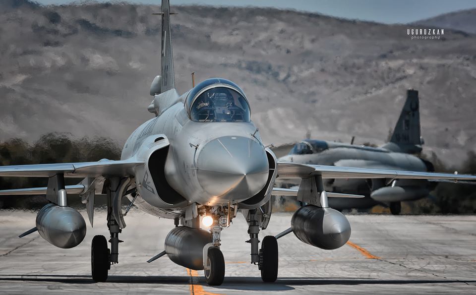

Your explanation does not make sense. I don't think the height of pylon would impact the plane stability or there would be no concept of CFT's. There are numerous examples of missiles fitted on top of wings as an urgent wartime solution with no impact on stability. The major reason as I mentioned in my original post and confirmed by others is the risk of released payload hitting the mothership
QUOTE="StormBreaker, post: 12570357, member: 197683"]There would be stability issues, I don’t know how to explain it to you, Let’s say, You hold some weights on both hands, Stand normally, Weights facing the ground, hands straight down.
Now, Just think, If you lift and stick both weights to your shoulders, You would easily tilt or fall off as compared to hanging weights on straight hands.
It is all about stability[/QUOTE]
The airflow that lifts the plane is above the wings not below. It's the vacuum created above the wings that hold the plane up not the air pushing up on the wings.
Keywords search: "pylon", "design", "flow", and "aerodynamics".
https://core.ac.uk/download/pdf/12042381.pdf
The investigations demonstrated the need for a careful contouring of the pylon/wing interface to reduce the adverse installation effects, such as lift loss due to the acceleration of airflow and subsequent shock caused by the presence of the pylon.
Differential pressures to produce lift is a balance first created by the wing foil. What you are asking for is a real time dynamic change of that balance with an extensible underwing store pylon structure. Safe ejection of external stores would require the pylon to extend itself, possibly under maneuvers, and that would produce unpredictable vortices that could produce disasters like video posted 10797. Then there would be reprogramming of the flight controls algorithms to accommodate that dynamic change. Then there would be the inevitable cost/benefits analyses to see if it is worth it to produce such a new pylon design.
Never used again.
