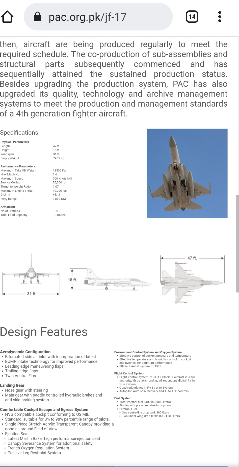

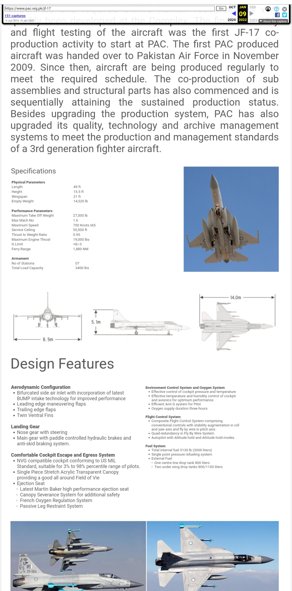

Was poor graphics work and silly formatting mistakes also part of the stealth plan from PAC Kamra? The random capital alphabets, the lack of consistency? Must be stealth too!?

JF-17 empty weight = 7965kg
M2K empty weight = 7500kg
So the JF-17 is almost 500kg heavier than the Mirage 2000 now?
Hence i feel for the first time without engine change its now underpowered
Once its get new engine like mriage 2000 got later blocks it will be agaun appropiate but with block 3 weight gain and same engine its under powered
