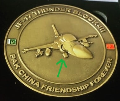

what do you think? I pointed this out before but some people have dismissed it as just bad artwork that is showing the centerline fuel tank as off to the side. I disagree. if you compare that device I pointed to with the green arrow, it looks nothing like the fuel tanks shown under the wings, not even remotely close. It looks like a pod, not a fuel tank...so I think the Block 3 WILL have AT LEAST one extra mount point under the right intake if not both intakes.
The pod can also be mounted on the center hard point. So being a pod instead of a fuel tank does not necessarily mean that it's a new hard point.
