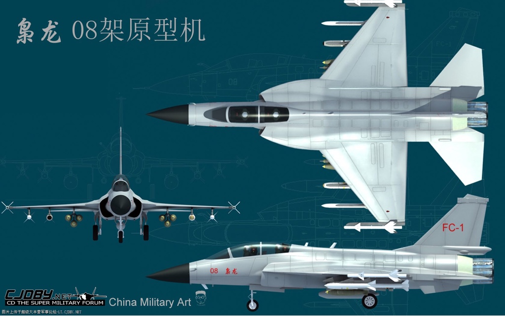

The JF-17 itself can be brought up to F-16 standards by simply improving its internal fuel capacity with a 100KN engine. 100KN engine doesn't require as much fuel as 130-150KN.
This type of 3rd under wing pylon for SD-10 class weight 200kg plus pylon weight needs to be added,wing spar/rib 2nd to last before wingtip on the outer wing by strengthening outer wing
Plus one underintake for ldp
It's fan art, but it can be done by lengthening the fuselage by 0.5m, which will allow a 10m wingspan. But thrust will have to climb up to 100-105KN from 85KN today.

New pylon attachment option after strengthening outer wing like f-16 there is enough clearance between pylon points
