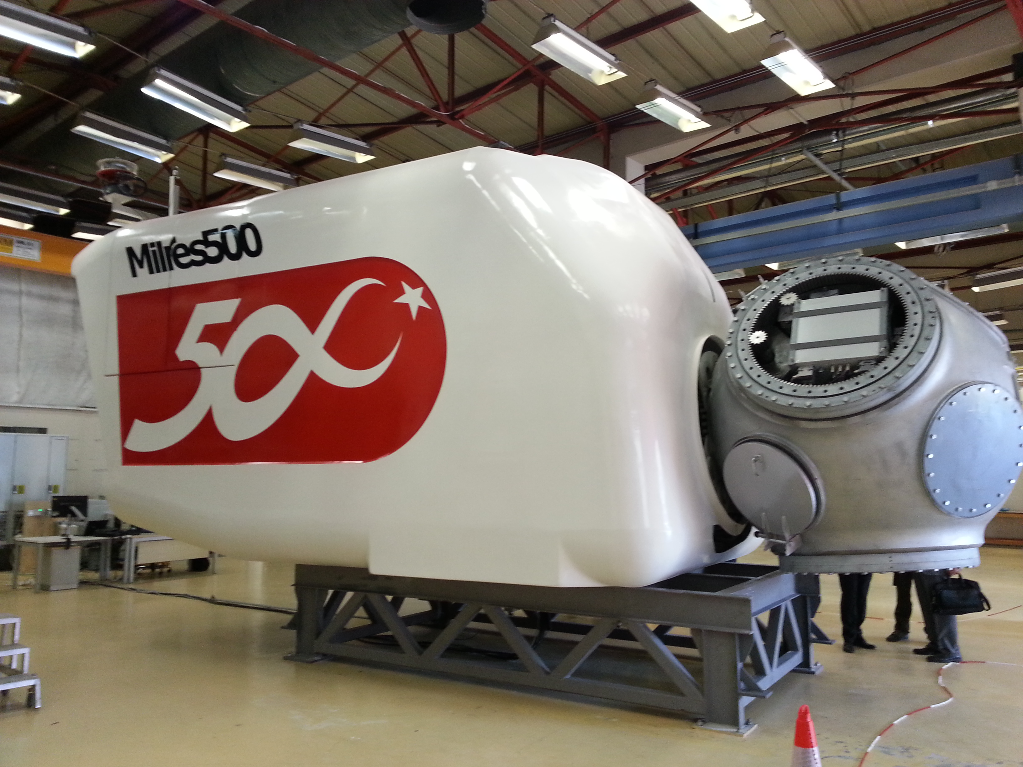

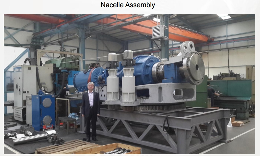

MILRES Project to develop 2,5 MW industrial capacity wind turbines • 500 kW scale prototype turbine will be developed first.
These turbines will be used as test beds to mature system design for applications in a 2.5 MW industrial capacity wind turbine.
Provide experience and ability for further development of 5MW-8MW offshore wind turbines in Turkey
Developed Turkey’s first; • 500kW double fed indicator generator
500kW wind turbine gearbox
forged shaft for 900mm diameter
forged ring flanges upto 3.5m diameter
Novel gear box design that allows stage by stage ( 3 stages) servicing
unique turbine blades
Unique aerodynamic and structural design,
Unique mold design
90% domestic materials (including fiber)
Some Novel Aspects of MILRES Turbine
Hybrid/Midspeed turbine design;
Gearbox output ratio is lower than standart wind turbines
Generator is smaller and cheaper than direct drive wind turbines
Full load wind speed is lower than competitors, which means more energy in lower wind speeds
On board (nacelle mounted) crane system for maintenance. This crane system has ability to service all nacelle systems. Some Special Aspects of MİLRES Turbine
