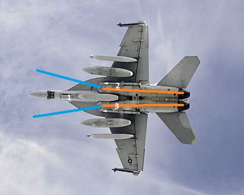

I imagine the reworked Engine placement for JF-18 would look similar to Hornet
Presently in JF17 Thunder the sections 1 , 2 , 3 are are 1 single piece
where in Hornet you have clear visual of breakdown of how Pilot's section is seperated from two columns for Engines
I think you have mistaken the word modular to mean LEGO.

The image below is "Scaled" model of Thunder. Only 2 changes have been made
1- The Engine which was positioned centrally has been split in 2 equal entities distributted across evenly each side, the plane still have a symmetery and balance (weight)
2- I repositioned the pilot's cabin more centrally to balance the plane out (While I admit this cabin area can be increased in length / width now
jf-18-reworked-png.382220
This hollow structure , fixed structure which houses the engines is presently manufactured as a SOLID 1 piece unit , this fixed part is the only part that needs changing from structural stand point and of course the tail
If we manufacture plane 99% in Pakistan with the Engine , the cost would be ideal for Pakistan's Aviation
  • A twin Engine Thunder , JF-18 , 99% made locally that should be the goal
Width is certainly added on cockpit area however the , front portion and cockpit area can have more length so front is narrowed depending on needs
I think we can see JF-17 , as newly evolved JF-18 would have larged Cockpit area wider, and the wider body will ensure some extra room for fuel
Mostly structural changes metal parts and body
Gains in such direction (A theoretical JF-18)
