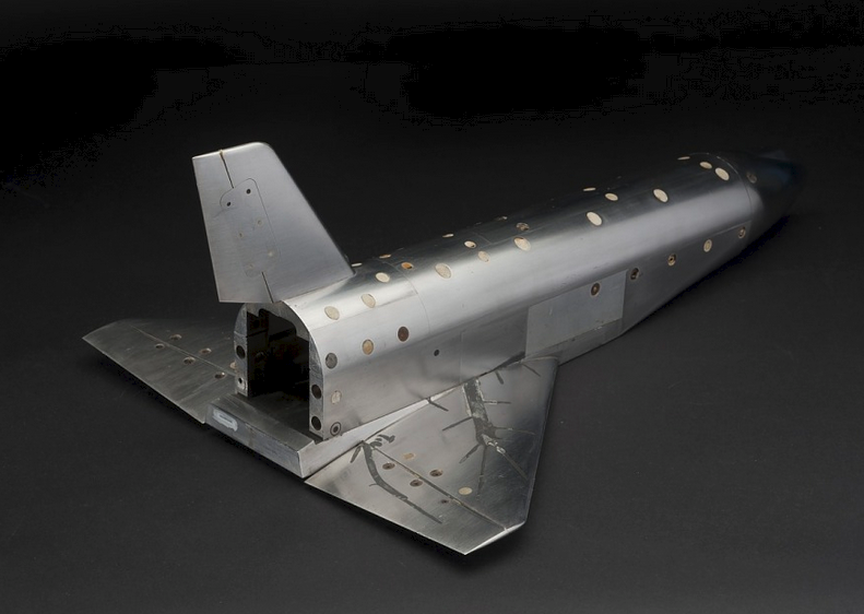

  1. Well instrumented wind-tunnels of various sizes and various speeds.
  2. A model-building shop that can make models for wind-tunnel testing and scale-flight testing. This place would need 3D printers, and skilled R/C aircraft makers, machinists. Might get a metal sintering 3d printer if I have the resources to make models for windtunnels:
    This shop will probably need 20ish technicians.
  3. Hire 10ish people who specialize in CFD and 3-4ish people that specialize in reduced order model. The idea is that computer models are built, tested using CFD and reduced order models (ROM), and some of these tests are replicated in wind tunnels and R/C scale flights to get actual data to correct the computer models. Then these computer models can be run millions of times for design of control systems.
