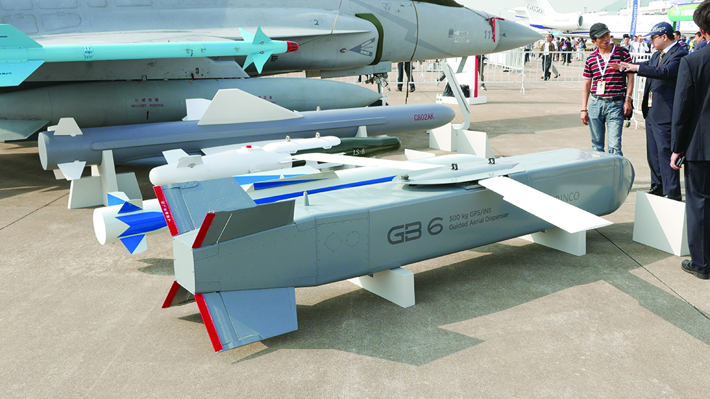

Fuel tanks is the easiest thing to do----the surface area will be bigger by default once the design is changed similar to the Gripen----from the existing tank. Round fuel tanks don't carry more fuel under this restriction ---you can make the corners and edges more aero dynamic while keeping the same width and height---maybe make it more rectangular
Here---the design is right in front of our faces----GB6----the current tank can be designed in this shape and the plumbing attached at the right places---.
This modification is the simplest and the easiest---and if it give each tank a 100 gals extra fuel----then once refueled in the air right after take off---I would say that we now have a loiter time of around 2 1/2 hours----+++which is sufficient for the time being.
I think this might need some structure modifications as well. If you look closely at the Gripen, it has a flatter belly which naturally provides for more surface area to house two fuels tanks in contrast to the round bellied JF-17 . With a round belly there isn't much space available for two tanks let alone all the piping needed to connect it to the main tanks and fuel pumps.
I think GB6's planer edges have more to do with lower radar signature.
rectangular tanks could work, but will need very precise placement on jet . if airflow on one side of tank can be reduced by little gap between jet & tank.
