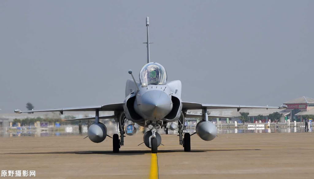

Sir Just look at the picture below and try to visualize what you are saying. You cannot bore holes and attach the pylons on the part near the intakes.

I apologize if I was not clear---I am not talking about changing the position of the tanks---but the shape of the tanks----. The location is what it is-----.

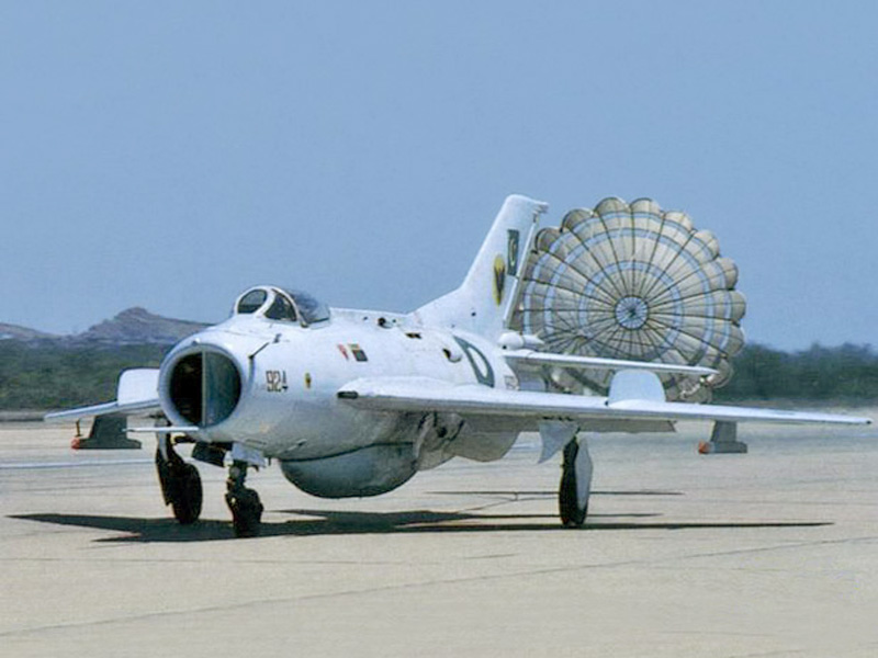

Nope its not, if F-6 could have it then with better tech available we can built light weight low drag CFTs for JFTs.
F-6 gondola CFT made in Pakistan.

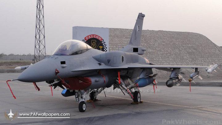

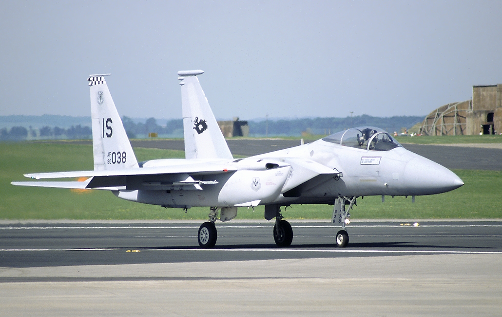

Here are few teen series jets with CFTs as per their body design.
F-15.

F-16.
Now, why JFT can not have CFTs??
F-15.

F-16.
