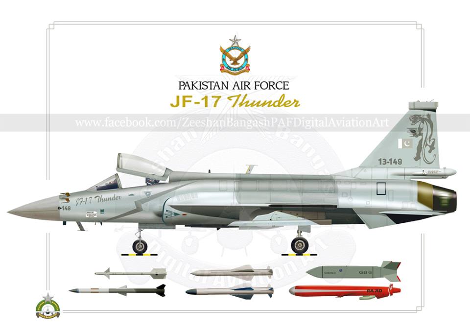

Just an art or Has RAAD actually been integrated with JF-17?
rd 93 is almost a similar engine upgrade from around 83 to 94..it is available and is undergoing testing but for whom?
there is no other single engine jet program?
so its reasonable to assume its for jf17, question is, is it for block 3 or block 4?
if for block 3, why didn't we see major structural changes for jf17block 3(apart from one hard point), it is possible that there are some changes that we dont see in photos.
or is rd93ma meant for block 4?
will block 4 then be structurally a bit different or will PAF simply take the additional thrust without enlarging the jet and do internal changes like adding more fuel and strengthening wings?
Up till now, there is no detail on physical and performance specifications of RD-93MA available from the manufacturers.
Therefore, there is no definite answer to your query about visible major structural change in JF-17 Block 3.
Aircraft structure change depends on the extent of physical parameter changes such as engine's length, external diameter and weight.
If there is very minor change in length or external diameter of upgraded engine, the aircraft structural adjustment will be internal, hence will not be obvious from outside.
Change in engine weight will effect aircraft center of gravity, therefore there will be changes in location of various equipment, fuel cells and sensors to bring back cg to its original position. Again not visible from outside.
