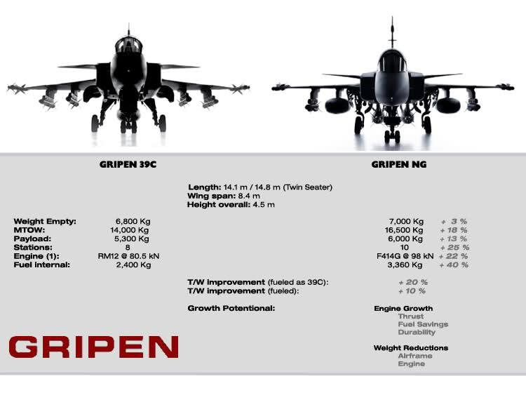

Illiterate people do not know that the original design of the JF17 was 25% larger design---which got compromised due to certain reason.
Illiterate people do not know that Grippen also upr=graded their aircraft to an almost 25% largest aircraft in the form of a grippen NG---.
Illiterate people also do not know that F18 Hornet also got bigger in the later production years----.
Yes, but then again with a very much different engine and not the current RD-93 ...

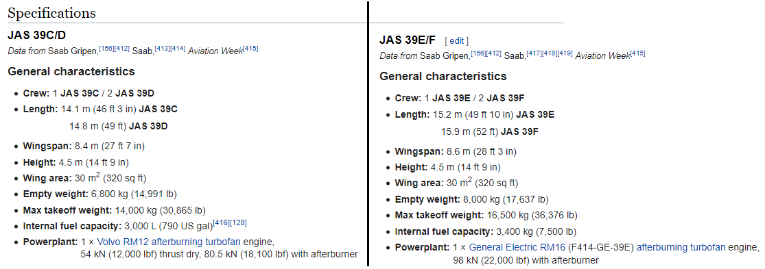

Again with the definition of what's copy or clone you seem to have a different definition of size!
You probably mean by volume and even if it indeed shows a growth of +20%, this is not 25% as you claim
Even more - and only illiterate people would deliberately omit to mention this - Saab had the option for a much more powerful engine with much more thrust (+22.5 %) for roughly similar dimensions, but this is an option CAC/PAC does not have for the JF-17; at least not yet (maybe when the WS-19 is ready).
As such a dramatically enlarged JF-17 in the same way as the F/A-18A/C grew or evolved to the Super Hornet is surely not impossible, but CAC will not do this for cheap, Pakistan cannot afford it alone and it will take time since it would require a new different engine ... and here we would again end up in a type similar to the J-10. But again, only "illiterate people" would omit to tell this in order to look others like fools, as if such a development would be easy, cheap and possible in just a few years.

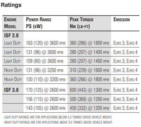

Well this engine and related structural changes subject has already been discussed here many times before. Let me add here again, being an automotive engineer i can tell you one engine can produce different power outputs just by playing with its calibration and upgrading critical parts like injectors, lubrication system, cooling system etc but keeping its physical footprint the same thus resulting in no-problems from integration and physical packaging point of view.
Just for reference, the below ISF 2.8 series light duty cummins engines come in various power classes from 109 PS all the way upto 163 PS, with just a change in calibration in control units. I myself have tested the same engine on the test bench with different ECU calibrations resulting in different power and torque curves altogether.
The same applies to optimizing jet engines too. For reference, take F100-PW-220 and F100-PW-229. Both have more or less the same physical footprint with some internal peripherals being replaced/optimized resulting in improvement of dry thrust from 65kN to 79kN and wet thrust from 106 kN to 130 kN.
