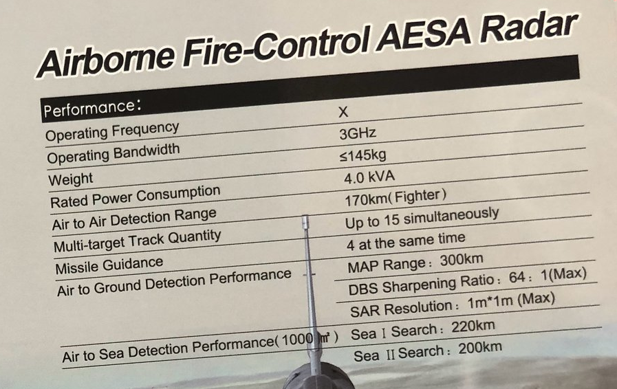

145KM is more than useful for the JF17.

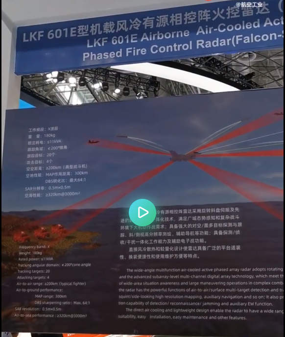

Air Cooled LKF 601 E radar Spec, Remember in first video of LFK letri radar they stated that radar is able to upgrade previous blocks as well without any additional structural modification
Range for fighter jets : est 200 Km
Air to ground Map : 300 Km
Air to Sea : 320 km
Track targets : 20
Engage Simoultenously : 4
They have improved/upgraded the radar including range, number of tracked targets from 15 to 20 and weight.
Biggest being sea detection and SAR resolution.
Because GaN TR modules are popularized in china in these 3 years,nearly all new radars that showed in ZhuHai are base on GaN.

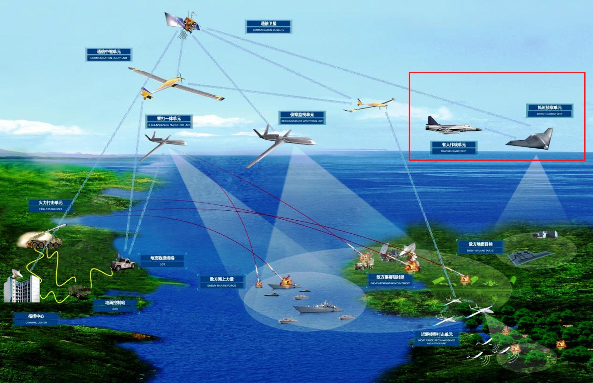

A glimpse of Block-3 Armament
This looks like a great paint scheme, especially for the next marketing plane. The color contrast between the plane and the weapons/pods really helps show them off.
Could just be a generic image to get the point across. Otherwise they may be marketing the capability of the thunder to receive live images from an unmanned platform (via datalink pod?) (and possibly even have its weapons guided by said platform).
However, I am not sure about the latter because they've depicted weapons firing from all units except the thunder.
By making the radar bigger and heavier. The performance increase is expected.
Air to Sea : 320 km
Track targets : 20
145 KG Radar versus 180 KG radar. Rather significant weight increase for a moderate performance increase.
Rated power consumption 4 vs 11kv has more than doubled
i very strongly doubt this
The Military commentator 施佬&席亚洲 interviewed lots of Radar manufacturer's staff in zhuhai,and finally obtain the above conclusions.I don's think you know more about this~~actually you know nothing about it🤣
