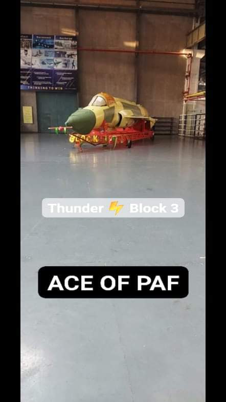

First locally produced airframe of JF-17 Block 3 in PAC, Kamra.
Note: This photo is a couple of months old.
By Ace of PAF

People who are not accepting block to block airframe changes it will settle soon. Perhaps to enhance sustained hard maneuvering without running out of fuel.
Hazir and I’m refraining from commenting specifically because the same arguments of “nothing getting done” or “wanting a cranked delta version with two EJ-200 JF-17” are back in play.
My input is that there are internal structural changes to allow for the chin hardpoint and along the wing root&spars to let outboard stations handle the stress of regular use of dual rails for MRAAMs along with increased capacity environmental control and electrical power systems for AESA.
In my humble opinion the images aren’t clear enough to conclude any changes in planform as such so it really is akin to a Block-20 to Block-25 change w.r.t F-16 barring the enlargement of the block-25’s tail for the ASPJ - that internal ECM for the block-III seems to have been accommodated in existing available space.
If they do have fuel behind them(which really can be fit into interesting places - then the coating may also be different as well which is why the different color.
Aluminum in aircraft is coated with different chromate compounds which vary from yellow to green. My contention is that green isn’t a hard and fast rule for fuel tanks -
Correction: the color of the primer is a add on color and not necessarily a different compound. So it may very well be used to differentiate between different areas (no step?!)
Interestingly, more modern construction is focusing on polypropylene based primers because these stuff is poisonous.

This latest picture looks like a disassembled prototype that already had been manufactured else where (most likely in China) and transported to Pakistan for testing. It's not a locally manufactured jet in process of being built otherwise we would see it on the assembly line. This picture is probably from last year
