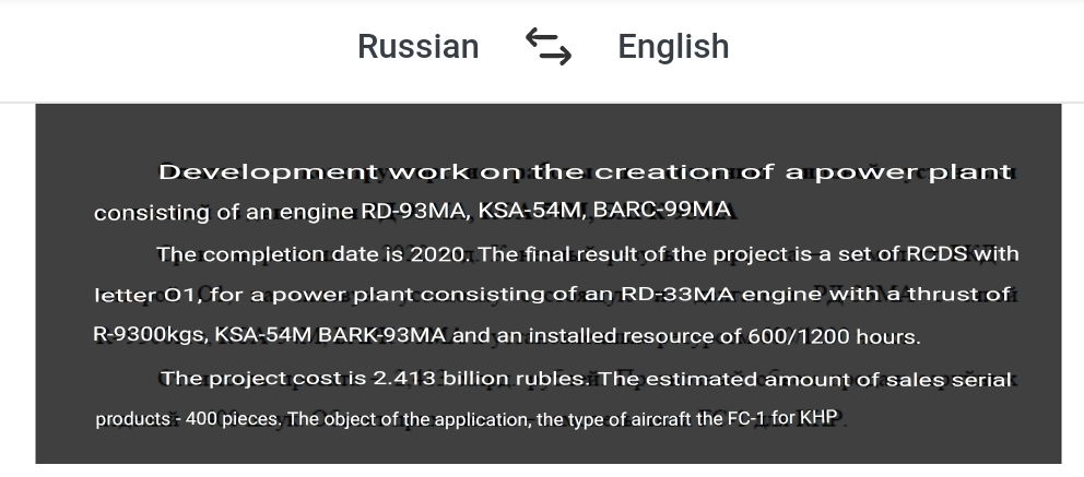

A friend of mine translated it and it turns out as this,
Experimental - Design works on creation of a power plant
consisting of RD-93MA engine, KSA-54M, BARK-99MA.
Completion date - 2020. Project outcome - RKD set with
with O1, for a power plant consisting of an RD-33MA engine with a thrust of
R=9300kgs, KSA-54M. BARK-93MA and set resource 600/1200 hours.
Cost of the project - 2.413 billion rubles. Forecast sales volume of serial
products - 400 pieces. Object of application - aircraft type FC-1 for China
So there's an order of 400 new and improved engines for JF-17?
That's interesting.
400-500 sounds about right if you consider the lifespan of the engines and the size of the remaining JF17 procurement by PAF ( about 200 units of Block III ) and engine refresh of Block I and Block II planes, before Azm and other platforms come on line.
Can PAF ask for license manufacturing or assembley or the engine, to help build the local infrastructure to design and develop its own engines in the future using the same infrastructure?
not all for JF-17. probably 100 for JF-17 and another 300 for 150 twin engine J31/J35
People are totally relying on what a certain defense news websites says.
The Russian defence contract website says otherwise.
Biggest news is that the Russian manufacturer Kilmanov is contracted to produce 400 units of RD-93MA and all are for JF-17.
