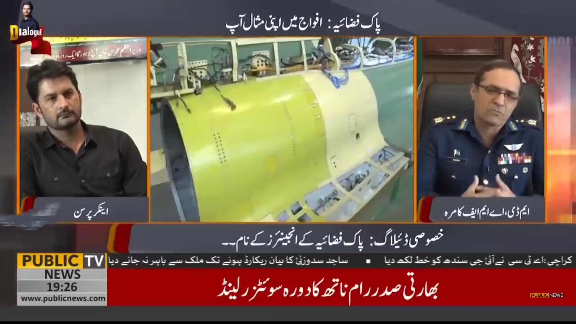

Blk3 has differences from B model. Notice more composites in the b3 all the way to the forward fuselage below cockpit, serial numbers, spine harnesses for avionics, fbw and fuel pipe for IFR. Also note thicker wing tip which is absent in 601/3.
Intake, leading edge, nose..
View attachment 578384 View attachment 578385 View attachment 578386 View attachment 578387 View attachment 578388
View attachment 578390 View attachment 578391 View attachment 578392
Sorry in case I missed it, but why are you so sure, this is the Block 3 prototype especially since that airframe is clearly labelled BCxxxx?
Sorry in case I missed it, but why are you so sure, this is the Block 3 prototype?
Likely, source is from AMF.
AFM ... so not again Alan Warnes o_O
sorry, I meant AMF KAMRA.
So finally Block III unmasking itself. Congratulations.
Sorry to nitpick, but I'm not sure especially since the airframe is labelled a BCxxxx.
