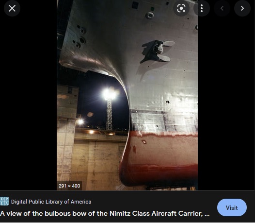

What is this?
Not an authentic source. DLPA is a collection of publicly available library items. The title is wrong. The actual item is just a picture provided by national archives. I will take the word of a thesis from MIT over such a source.
If that site is wrong then please provide a source that describes that part of aircraft carrier.
"That part" is called bow of the ship. And bow has many designs -- including bulbous bow.

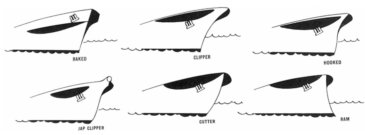

Some interesting designs through history are covered here :
From the looks of it, this is a clipper bow or a blunted clipper bow.
Larger and newer U. S. ships are usually designed with characteristic blunted clipper bows, often difficult to distinguish from t he raked type common in lighter units.
For a bow to be called a bulbous bow, it should be designed to provide advantages of bulbous bow ie reduction of drag wave. Just because you see a protrusion, its wrong to infer that the ship has a bulbous bow. Check this out. Do you think this ship has a bulbous bow?

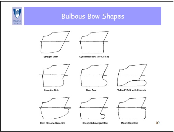

What is this?
And which one of these does this (CVN-68) matches with?
Remember, all of them have a BULB sticking out for the bow to be called bulbous bow. The design line of CVN-68 lacks that bulb. Also these drawings are in 2 dimension. The bulb is a 3-d shape.

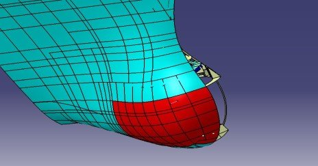

For a comparison, here is Battleship Yamato which has a typical bulb associated with thick Faired-in Bulb and Ram bow. CVN-68 lacks that.
Here is another scale model to see how thick and swollen up the bulb needs to be.
CVN-68 Bow lack this thick bulb and is a V-shaped blunted clipper bow.
