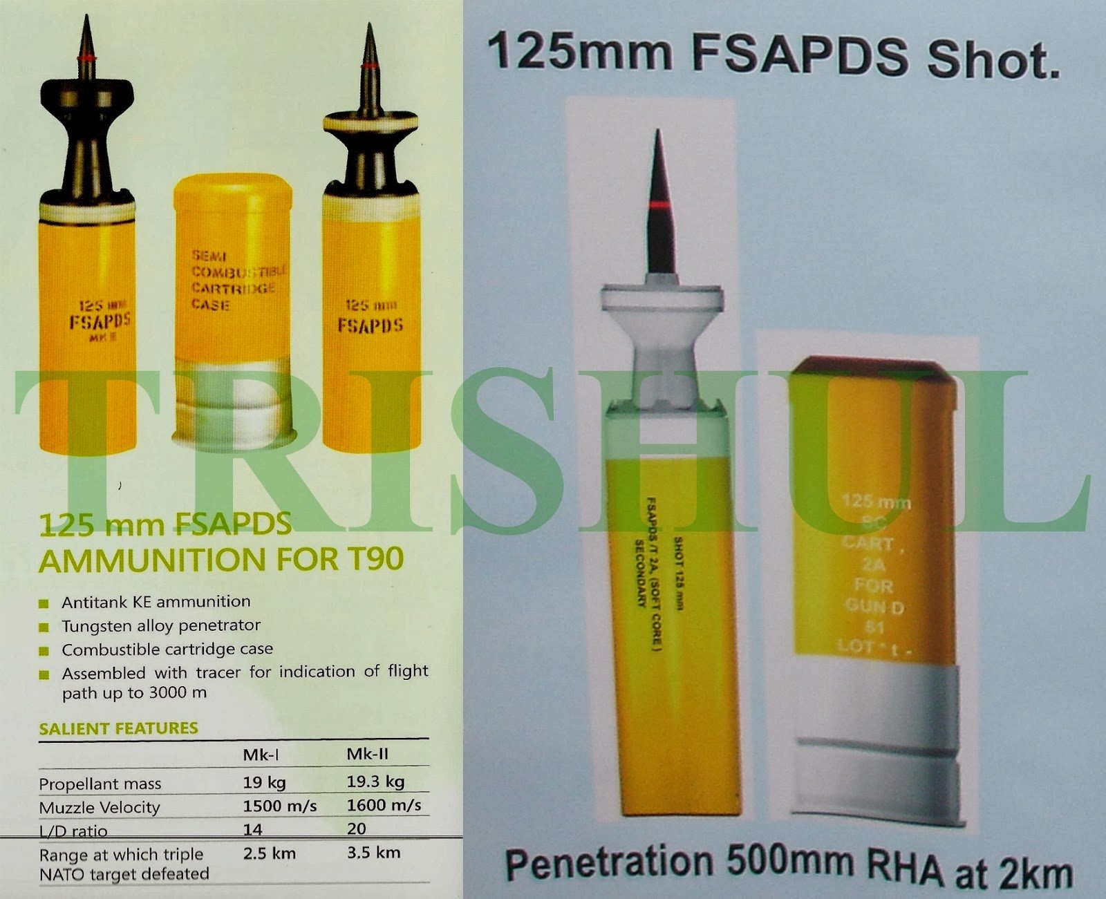

India has purchased MANGO rounds but also has developed indigenous APFSDS which can penetrate 700mm armour and displayed in several weapon exhibitions. It is inferior to the 800mm penetrators of Russia but it is much cheaper to make and better than MANGO round.

Firstly, you have different definition of indigenous. What I call as indigenous is what is manufactured in India without any imported components. So, even though the ERA, thermals are of foreign design, they are indigenous as India has mastered the technology to manufacture in India without any import. The license manufacturing does not mean India imports components. Tehre are different types of license - India has fully obtained the technology and hence can manufacture all its basic tank needs using its own inhouse production. Pakistan imports and assembles it.
Also, the APFSDS is meant for T90 as it has 120mm caliber, not 125mm caliber. This is only suitable for T90 and T72, not Arjun as Arjun ahs 120mm rifled gun. Rifled guns can't use AAPFSDS anyways and hence India will not develop APFSDS for it. Here is DRDO official article claiming that 40k rounds are annually produced: https://www.drdo.gov.in/fsapds-ammunition
India is developing Mk2 version with 550mm penetration at 2km from 500mm at 2km. India has developed it last year and has even placed an order for it. To develop 700mm penetrator, India needs Depleted Uranium sabot which India does not want to use. You are using outdated information when talking of 300mm penetration. In fact, Arjun tank has no APFSDS capability due to its rifled bore (rifled bore can't fire APFSDS).
India uses Kanchan ERA, not Russian ERA. India keeps upgrading the ERA technology too but only the new production variant gets the new ERA as older armour is not replaced. India has indigenised the thermals and is currently upgrading to latest version of thermals. Even there, India has achieved high amount of self sufficiency.

'Rifled guns can't use AAPFSDS anyways and hence India will not develop APFSDS for it.'
Ahahaahahahahah [emoji23][emoji23][emoji23][emoji23]
'India is developing Mk2 version with 550mm penetration at 2km from 500mm at 2km. India has developed it last year and has even placed an order for it.'
1) we made the naiza du with the same penetration in the early 2000s.
2) it won't be enough to knock out our front line tanks
3) 600mm is the average for armour pen of ao modern day apfsds round, so it's outdated even by today's standards.

that is literally rebranded mango, 500/0 Deg 2KM is only 40mm better than mango, still ancient. 550MM (still under development) is still 100mm behind what Pakistan is using and has Been using for years.

It is not rebranded Mango. India developed it indigenously. ALso, Pakistan does not make thermals, FCS indigenously. It is imported from China. These involve semiconductor technology and some other technology which Pakistan does not have
But it’s barely any better than ammunition from the 80s. So what’s the point?
