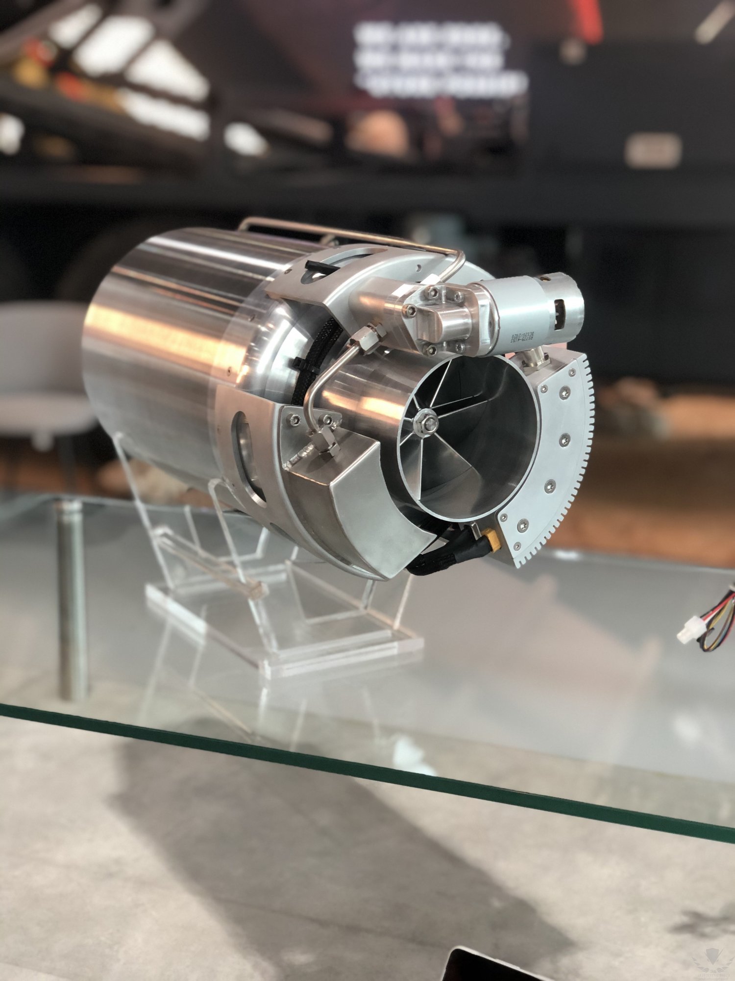

I have also heard that a team of 3 engineers at Halcon developed 3 different turbojet engines but not sure if any are large enough to power this.
@Bilal Khan (Quwa) @JamD
You guys might know more about engines for cruise missiles?
The jets in the picture seem too small to power the missile but that doesn't preclude others being used. For an idea the engine powering the harpoon is around 30 inches long so bigger than these.
I wish somebody grabbed those brochures, thats too bad. I found another picture though of the biggest engine. How much thrust do you think it could generate? Enough for maybe a small cruise missile like SOM possibly?

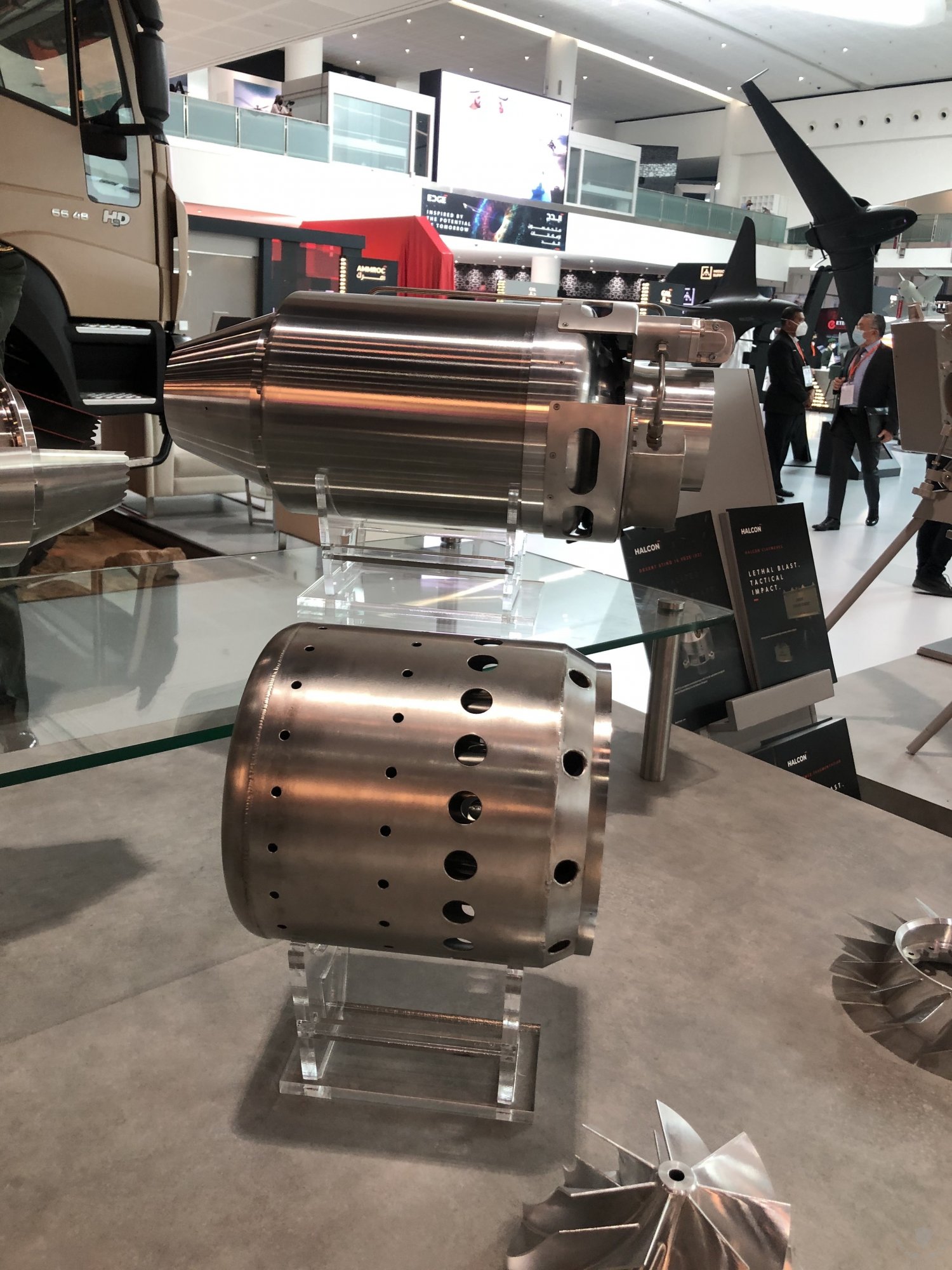

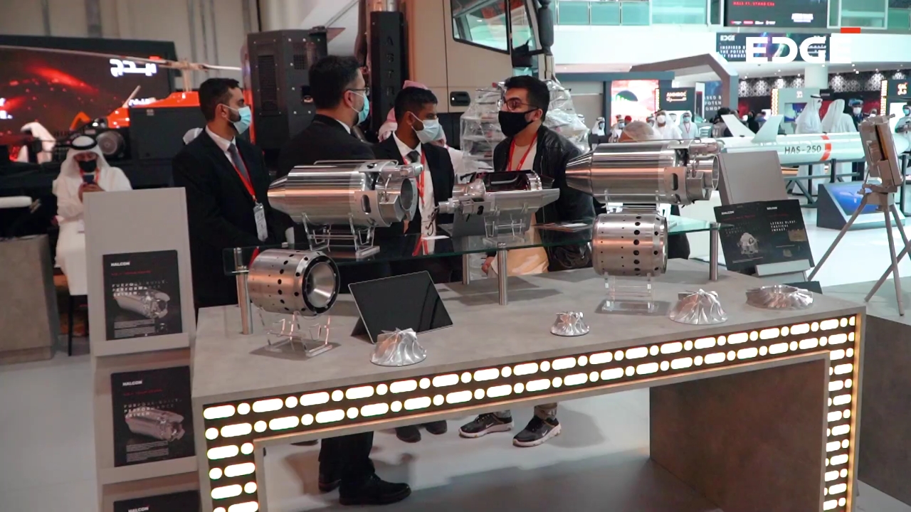

Yeah, the engine is too weak I found the brochure and the strongest turbojet generates 1kn of thrust. They are being developed for different missile, and UAV applications. The engineer of (Indian?) South African descent designed a few turbojets at a South African company before moving to the UAE and likely based their design on these turbojets.
Unclear if they are going to work on more engines or buy off the shelf engines, the engine being named HS-350 may point to it generating 3.5kn thrust similar to the amount that you said it would likely use.
No clue if UAE will pursue a non-MTCR missile, but they are working on Kamikaze UAVs with 450km range suggesting that they may not follow MTCR. Although not sure if that would even apply considering it is below 450kg of weight.
Loyal Wingman type UAV is certainly a big advancement that will require drone, and AI technologies for sure, but should be as you said an extension of previously learned technology.
Engines from Halcon
