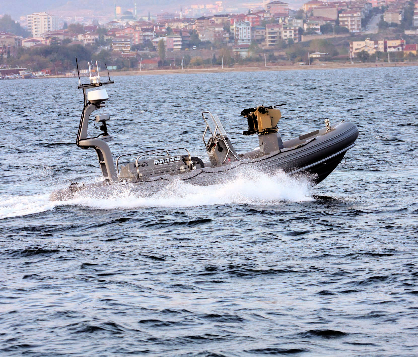

Aselsan LEVENT Unmanned Surface VehicleView attachment 31698
I don't know if these systems will be used on that boat... So i think this boat is a test bed and after these tests finished they will produce real platform... Maybe platform will be this one or something like that... ASELSAN revealed this design years ago...
