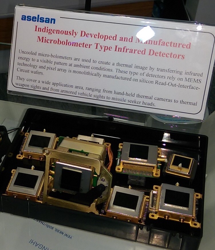

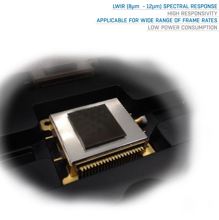

Uncooled Infrared Thermal Detectors (Microbolometer)
Success gained through product focused activities on
Microbolometer Type Uncooled Infrared Detectors has in 2016
lead to the decision to invest in a mass production line within
ASELSAN’s facilities. Following the preparation of a multi-phase
investment plan, hardware procurement has started.
The facility is planned to be operational in 2018. Manufactured
detectors will primarily be used in ASELSAN’s product lines of
Thermal Weapon Binoculars, Armored Vehicle Thermal Sight
Systems and Missile Seeker Systems.
