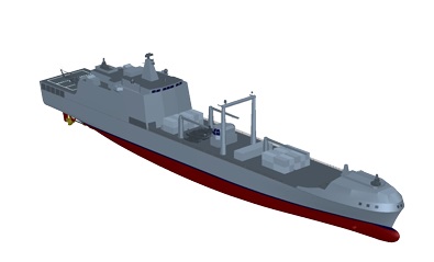

There is 2 projects i'll show you and i never saw 1 of their design...
1-DİMDEG...
From SSM...
Denizde İkmal Muharebe Destek Gemisi
Design is this... From STM...
Deniz Projeleri > Projeler
BUT i couldn't find this project's design...

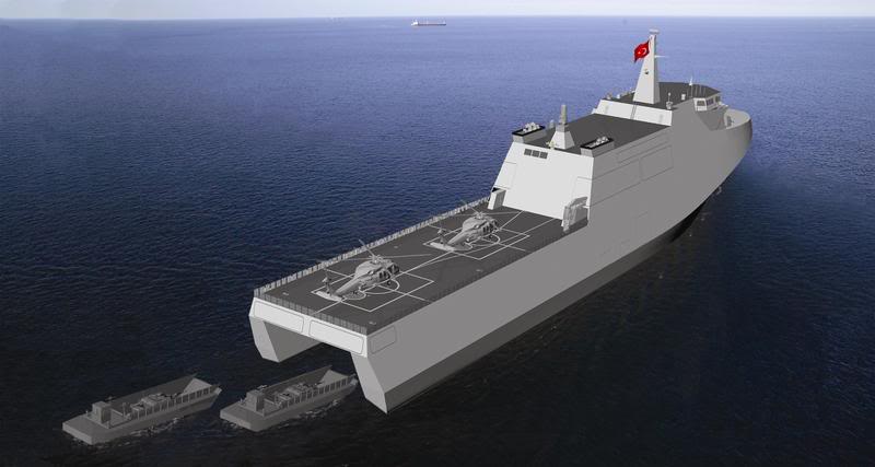

2- LDG
From SSM....
Lojistik Destek Gemisi (LDG)
Did you ever see design of it ?... And by the way in last SSİK this project's result announced and SELAH SHIPYARD won the tender...
1-DİMDEG...
From SSM...
2- LDG
From SSM....
İ ever passed by Selah shipyard, honestly i didnt see any kind of work inside :D there would be a ceremony i think if its keel laid. btw i didnt get point of LDG for our navy , when i look at mission of LDG , its told be deliverance of non military equipment, vehicles (like medical things, or other supportive units ) i expect a design mix of DİMDEG and LST design . i havent seen design of it yet.
I'm sure it will be so good otherwise our navy will never accept it... LDG will be an amphibious ship...
Amfibi Gemi Grubu
İt will be amphibous but i think it will have a stern door with capability of RO-RO while able to beaching :)and it wont be like LST with armanement and carriage of tracked or heavy duty vehicles ,might have a Helo landing deck too ? i havent read RfP . since Selah won tender, i think thats not something very onerous.
