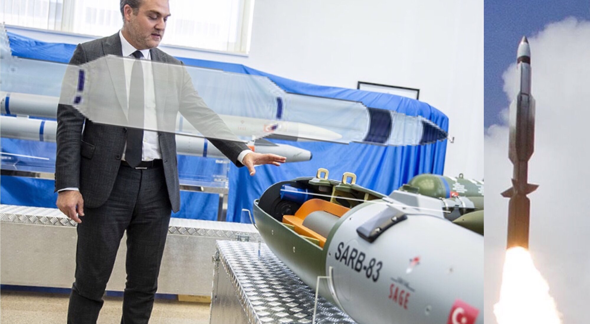

Bro, As you stated The missile geometry seems to fit SM-3. I don’t know how long the back of missile (booster+back fins) is reaching but I can predict the visible part of missile may have a length around 5m (by judging the length of Gokdoğan missile ~3,5-3,8m).
If we take the perspective into account as Gökdogan and Bozdogan are closer to the camera the hidden missile could be even longer, maybe somewhere around 6m.
