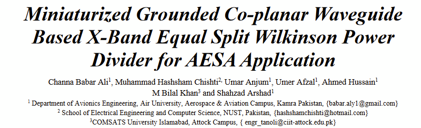

@Bilal Khan (Quwa) contrary to what many of us were thinking, this does not look like just a systems integration exercise. There seems to be work on the actual T/R modules too.
GaN based, 15W per module😍
