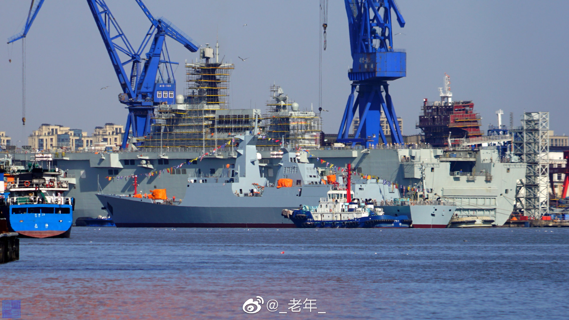

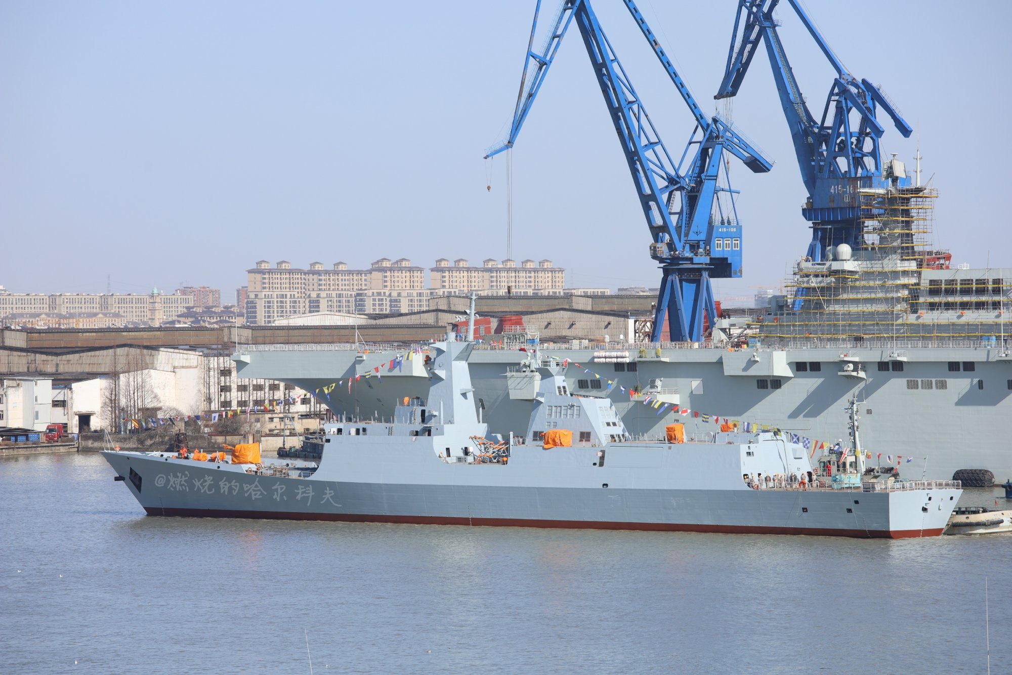

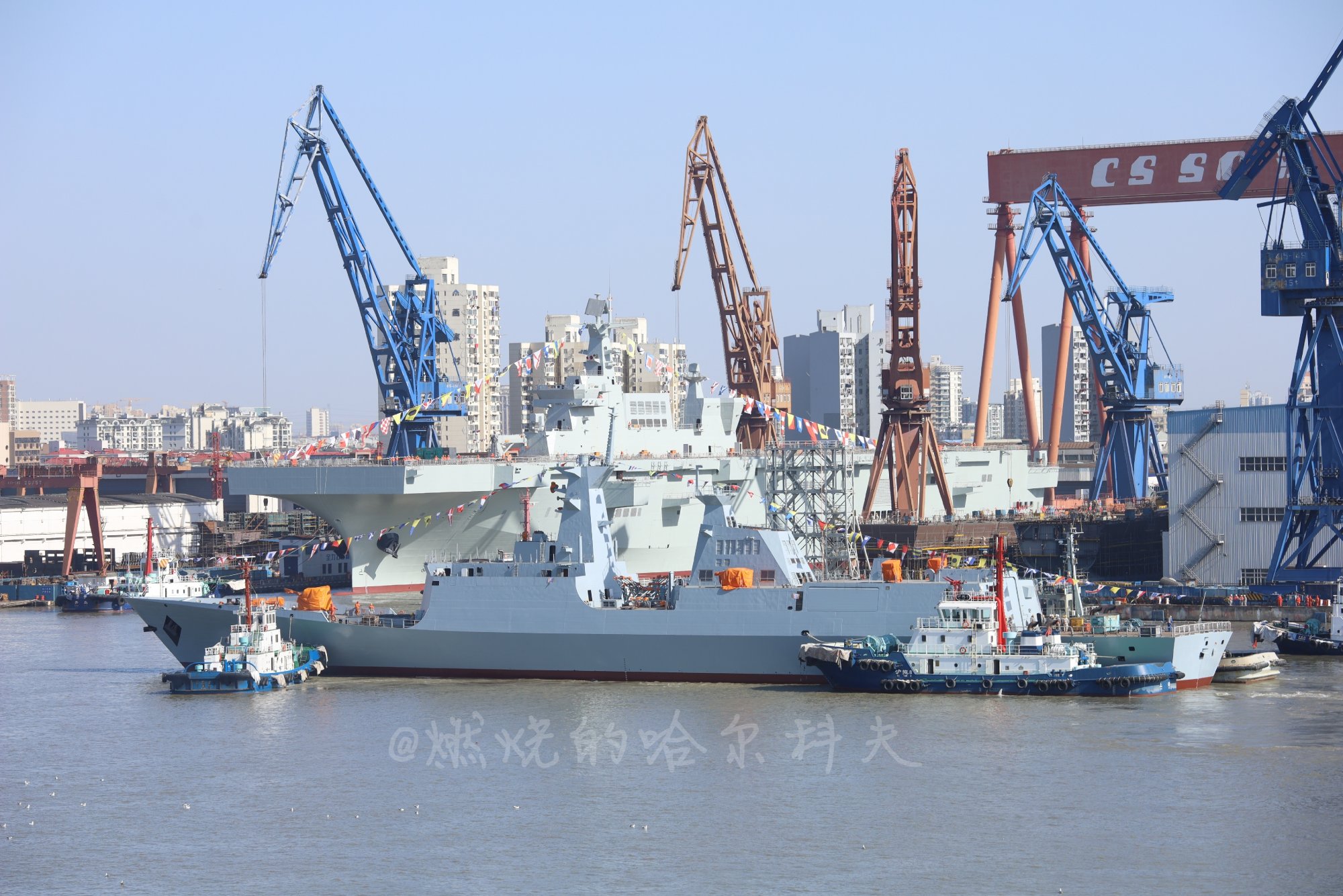

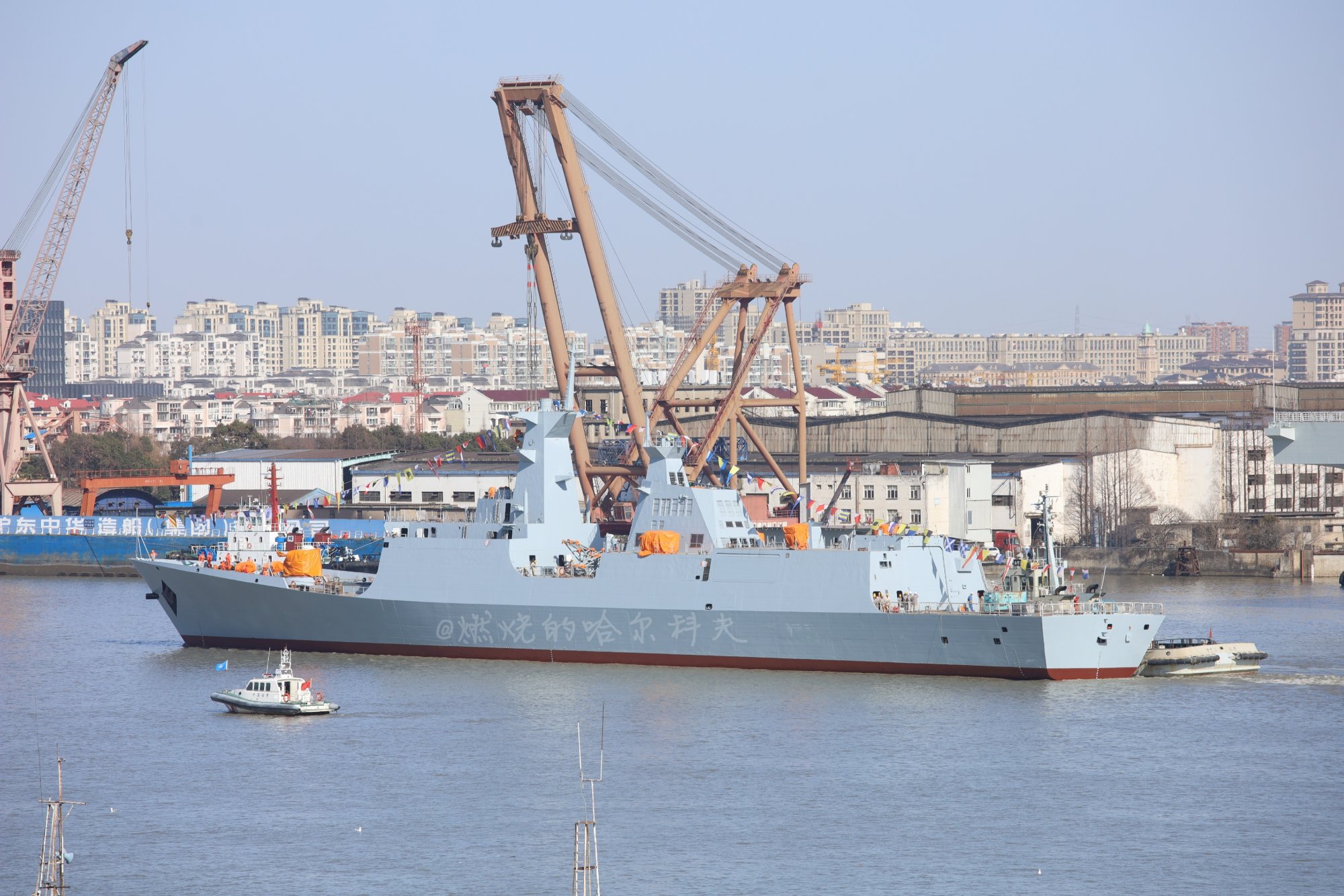

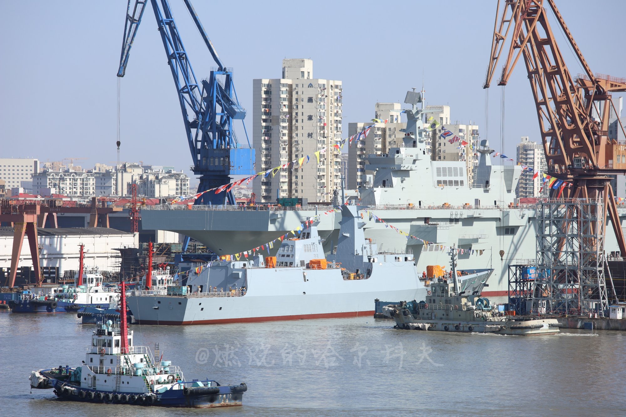

Type 054A/P #2
January 29, 2021
View attachment 711513View attachment 711514View attachment 711515View attachment 711516View attachment 711517View attachment 711518View attachment 711519
Via @燃烧的哈尔科夫 from Weibo

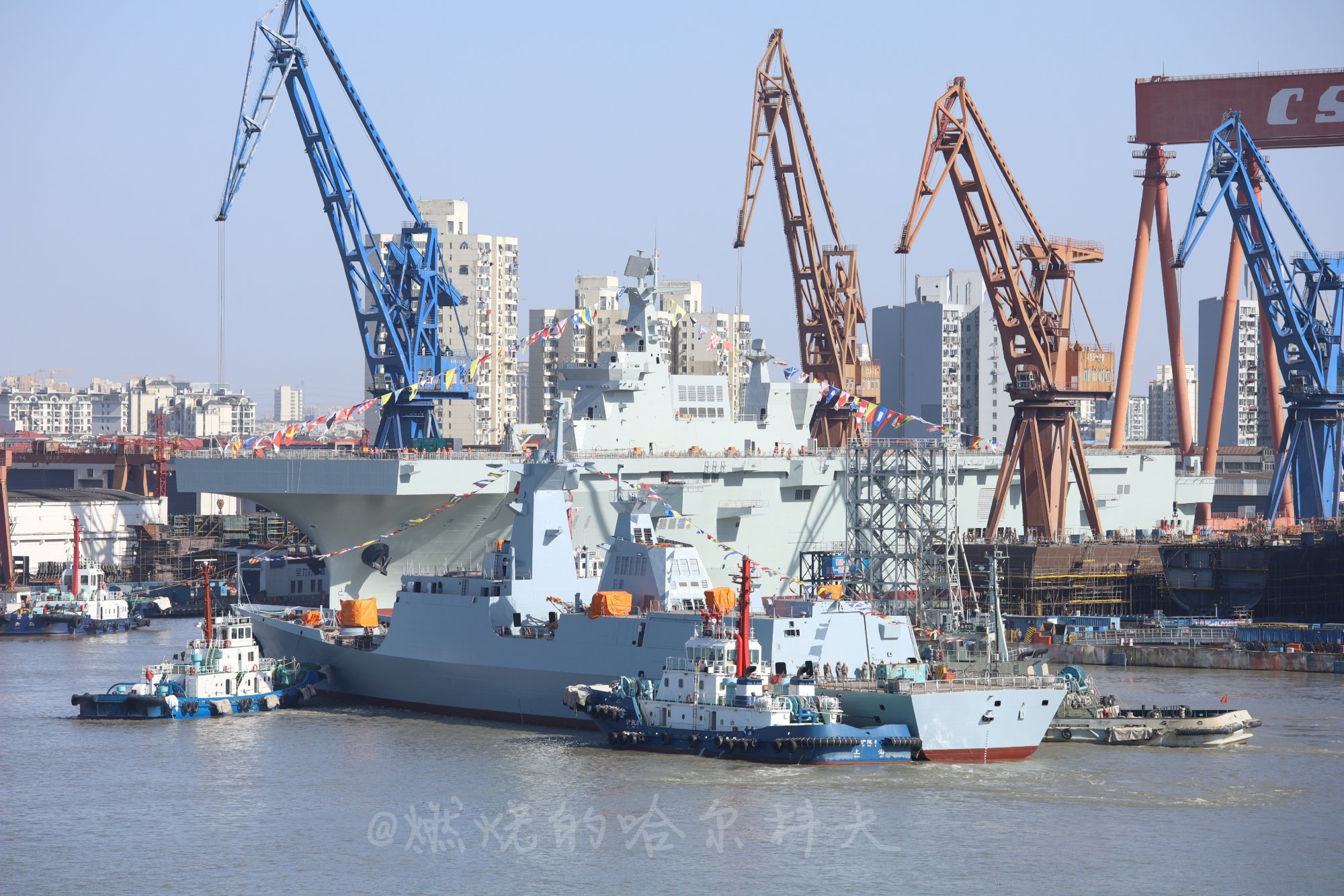

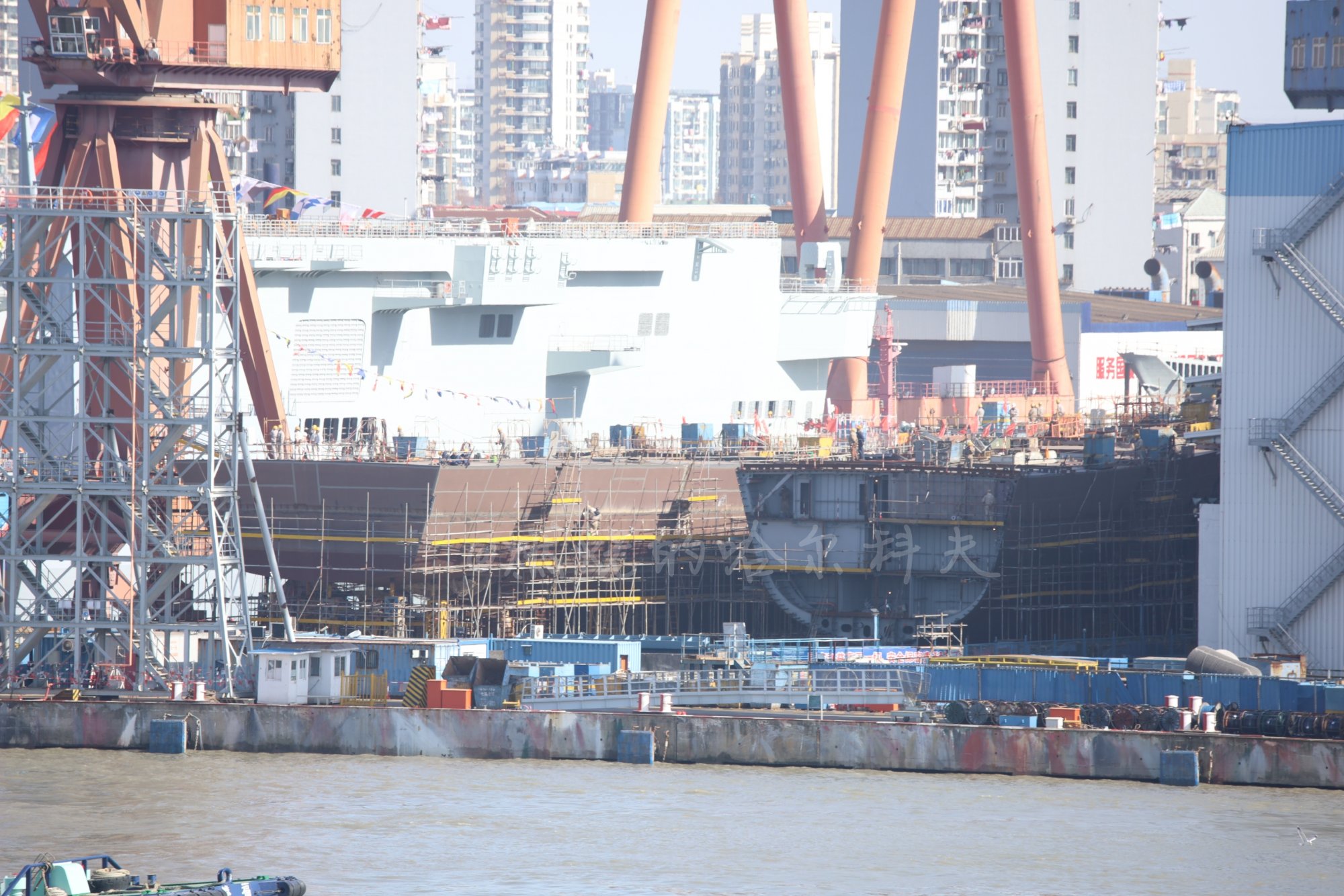

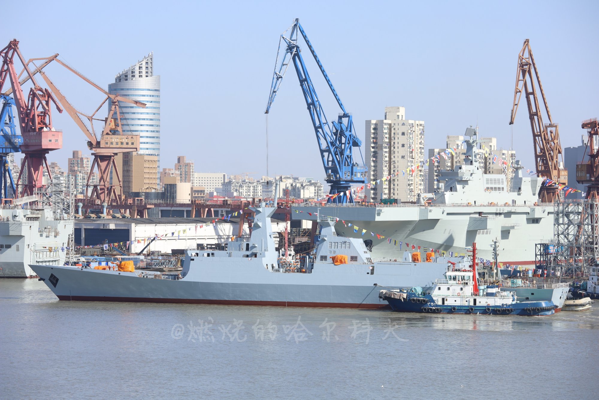

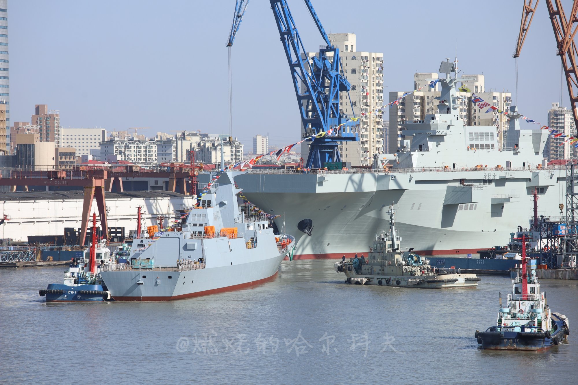

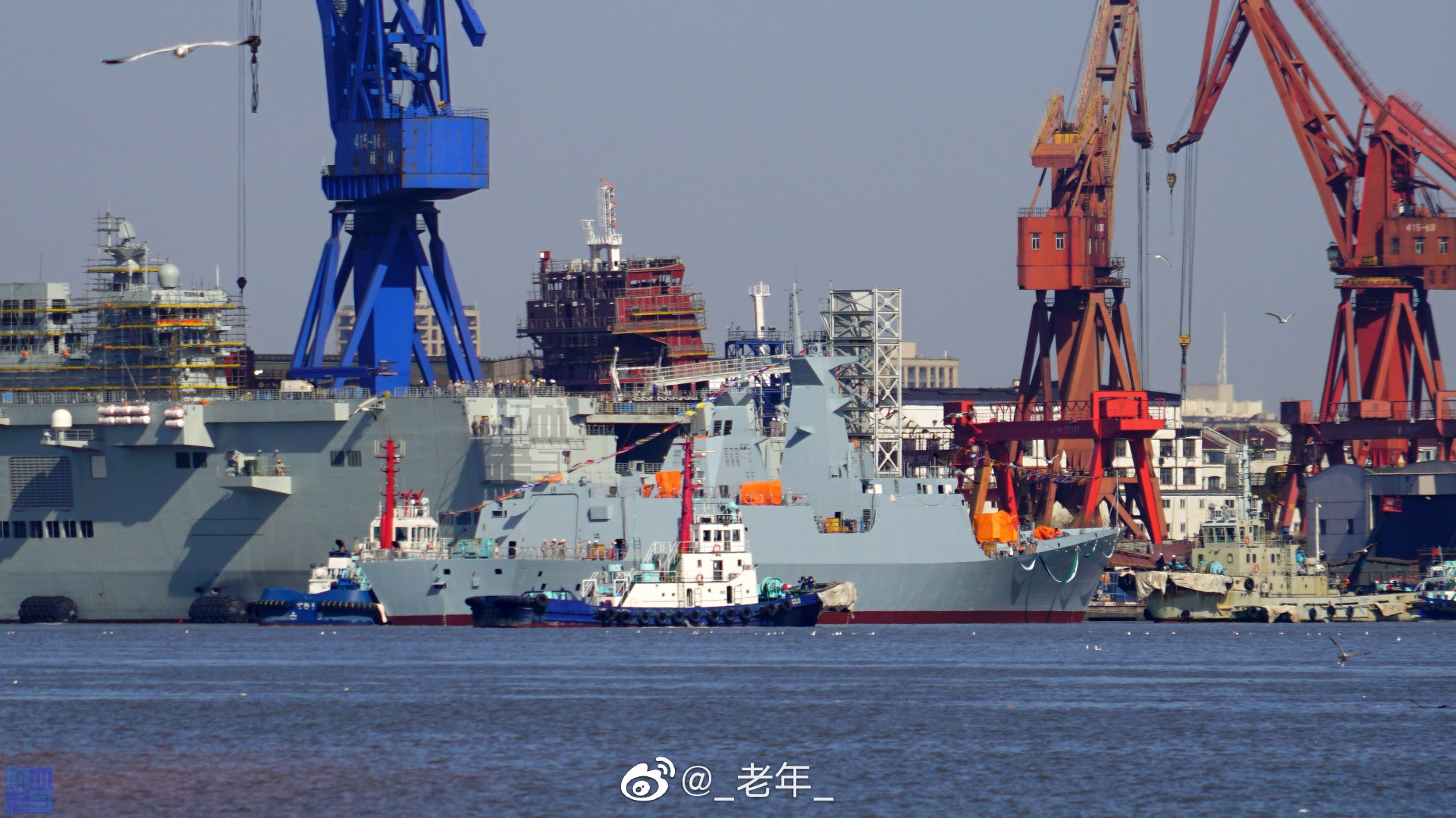

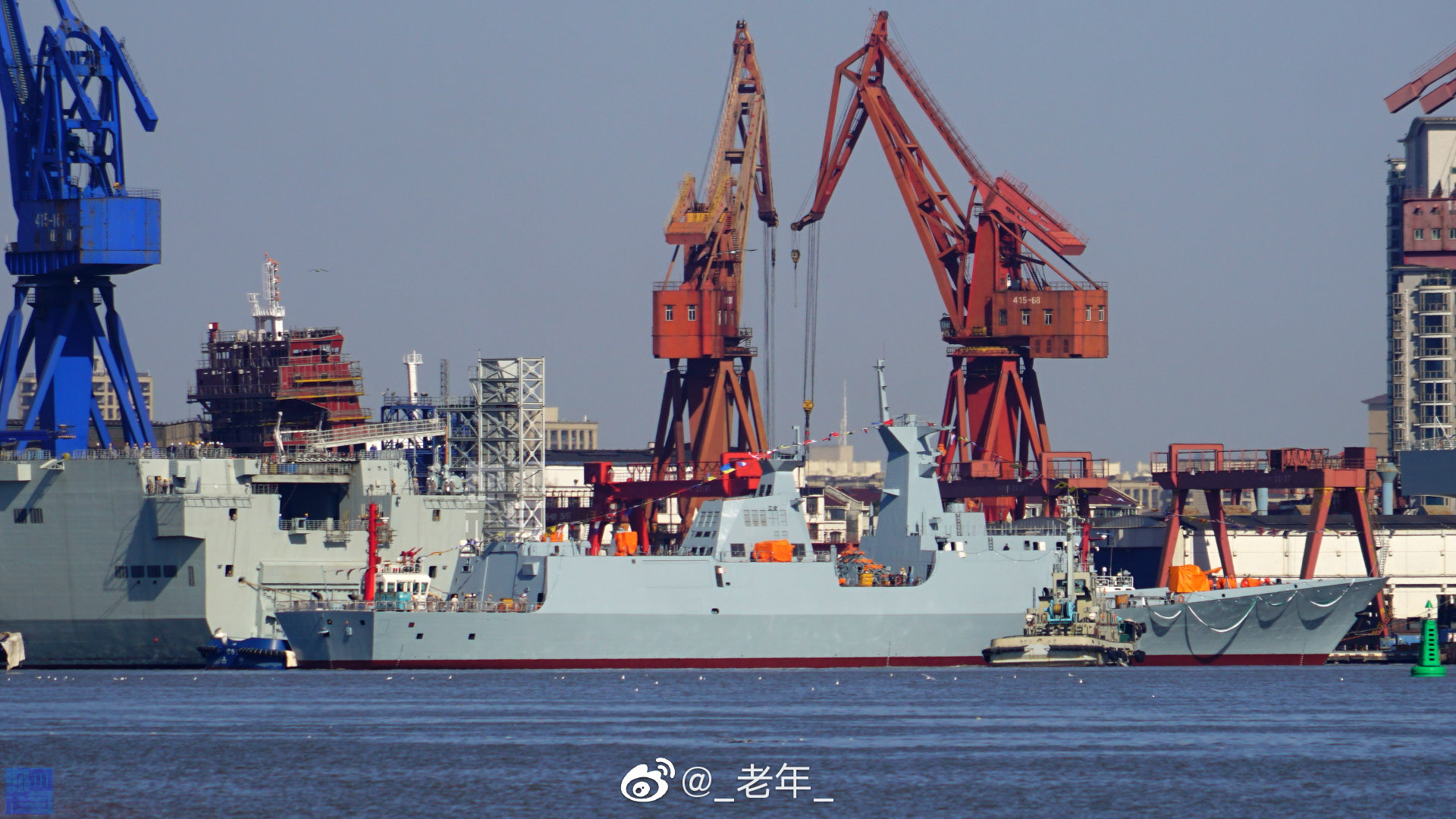

Type 054A/P #3
