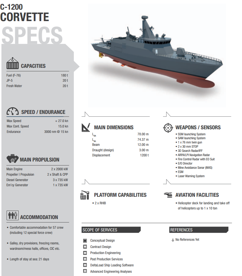

Out of curiosity, since the STM C-1200 corvette is advertised for having a SAM and being capable of air defence roles, is it possible to integrate a VLS to this design? Where could it even be placed? I am thinking it would be between the AShM launchers and stack, but there's some kind of mechanism in place there. I think one could consider VLS-only and place AShM in there?
@Penguin @cabatli_53 @Taygibay
View attachment 386176 View attachment 386175
Very short duration, only 21 days.

Likely in this size corvette you would have a PDWS style SAM like RAM or FL-3000N. The 22km RAM Blk 2 would make this a potent little vessel. Something like this or the Type 056 is more in line with what PN should acquire if all they want is a peacetime patrol vessel for antipiracy and SLC keeping. MILGEM-ada is too large and expensive and has few additional benefits from a weapons perspective.
If they want most capable vessel, a variant of Tiger/Type 057. If they want cost effective multirole, then I-class or LF-2400 with hopefully a quad-packable SAM like CAMM or K-SAAM.
As is, the answer is no, mate. This ship is just
too short & small to find enough space for a VLS.
We've done marvels in packing punch into vessels
these last few years not only because components
and weapons have shrunk but also thanks to auto-
-mation which allowed a major crew reduction.
All of this said, there remains a physical limit to be
respected and both for range and humans, this is
incompressible. You need a given volume of fuel to
get around at relatively ISO engine performances.
You just can't cut living space too much as it makes
your crew fatigue faster, sooner than mission's end.
In the end, size does matter and if the mission is
moving your 2 bedroom apartment, a Tata Nano is
too small, a pick-up should bring everything if not
at once and a big rig semi is just too big.
It's like that!
If a hull extension isn't possible, pick a bigger boat.
All the best to you and yours, Tay.

I don't suppose C-1200 have capacity to carry VLS system as other members stated but more compact SAM system is possible If required.
