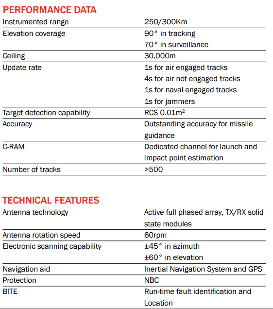

https://www.google.com/url?sa=t&rct...et.pdf&usg=AFQjCNGV2psS3oetG3ibpkmu8-bos1PESw
Your knowledge of the Pakistani radar scape seems to be limited and out of date.
