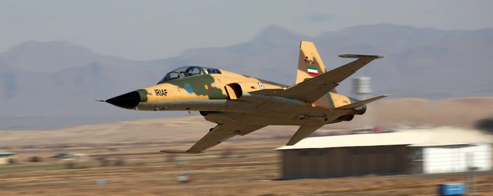

Kowsar Ver II - Possibilities !
@gambit
sir can you add anything regarding the feasibility of integrating Lyulka AL-21 to F-5 structure??
another question is that if it's possible for jet engines to work in their 10% of max out put power or not?

When Boeing changed to the new engine in the 737 Max, the new engine upset all the balances. With the new engine, the aircraft have a greater RATE of pitch change and a higher angle-of-attack (AOA) sooner after nosewheel up. So Boeing created a software compensator (not fix) for a hardware issue (not problem).
The point is not about the public relation disaster but about that out of balance condition created by the new engine.
The new engine may fit in the F-5's engine bays, but what about performance in flight? Airfoils are designed specifically for a range of airspeed and altitude. The new engine may make the jet faster and accelerate rate higher, but that could also affect the departure from controlled flight envelope.
https://www.cnatra.navy.mil/local/docs/pat-pubs/P-1216.pdf
Departure from controlled flight is that phase of flight during which the aircraft transitions from controlled to uncontrolled flight (Figure 2-9)...
Every aircraft have a figure 2-9. That bar in the middle of the chart will be different in location and tilt, but essentially, every aircraft have that chart.
It literally took yrs for the F-16 to change the opening of the intake and that was required with the new engine and you can see the intake difference here...
Pratt Whitney top
General Electric bottom (larger)
What if the F-5's current intake shape and size is too restrictive in airflow for the AL-21? Now you have to modify the F-5's intakes.
Am not saying it is technically impossible, but there are ramifications that will take yrs to resolve.

We should base a modern inhand platform such mig29 and define new project that inject f14, f4, f5 and .... Features on it and stealth feature also.
Qaher is :
Small but installing j79 or Al21 on it with size up-scaling give more power than f20 or Pakistanian jf-17 or f16 also in single engine configuration.
If you put in 5th gen avionics, radar, missiles and hardpoints on a modified Mig 15, you have something that at long range can shoot down 4th generation fighters.
The F-5s' airframe main disadvantages are dogfighting.
The aim of Iranian domestic air force R&D should be toward this focus of long range interception of 4th gen fighters.
I would put them on a Mig-29 airframe though. For better maneuverability and more hardpoints.
I would like to know where I am wrong in this thinking. The Chinese J-10C is not an attractive fighter but is 4.5 gen and can fire very long range Air to Air Missiles. That should be the top priority of most fighters, hitting the other jets before they hit you. A modified F-5 with very long range missiles can do this almost as good as any 4th gen fighter.
Going this route develops domestic fighter production. And eventually Iran will be producing 5th gen fighters, by not being reliant on foreign exporters of 4+ gen fighters. Iran will have already surpassed that.
the main advantage of F-5 is it's high quality dogfighting capability. F-5 in a dissimilar air combat trainings in US achieved 2.5 kills against F-15s and 2 kills against F-14s with only one looses against each. but yes it's biggest disadvantage is it's airframe, for example the rudders added to saeqeh decreased it's max range, the avionics added to kowsar decreased it's service ceiling and max speed. the main problem is it's engine, if the promised J-90 engine becomes available the problem would solve.
