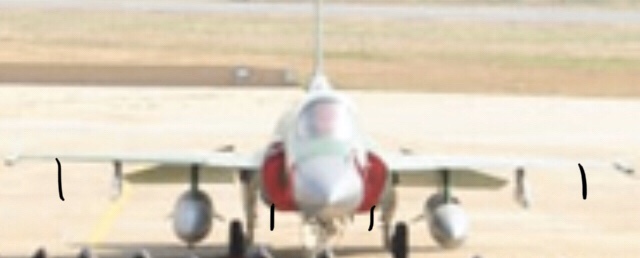

L-15 wings
It’s span is same as jf about 9 plus meter with three underwing and wingtip hardpoints
If only adding hardpoints was as easy as putting lines on a picture... you do realize the further away from the root of the wing you get the greater the moment of any added weight is, putting stress on the wing structure. Also the wing chord tapers as we move along the wingspan therefore less structural strength to add heavier weight.
It requires considerable amount of strength improvement in the whole airframe and specifically the wings to add extra hardpoints. Which all adds to the weight of the plane, and if the engine is not improved to account for the additional weight the overall performance of the jet decreases.

Shoulda coulda woulda ... but we have to work with what we have now. In my non-trained opinion, the only way to see an additional hardpoint is if we redesign the entire wing. Could make it bigger, use lighter materials to save on weight or utilize current hardpoints with multiple ejector pylons. The least costly and time wise would be the latter and I think its what is realistic as well. When we will actually see it, who knows, but would be good to have.
I agree multiple ejector pylon is way forward for JF17 or cfts to free up some space from drop tranks.

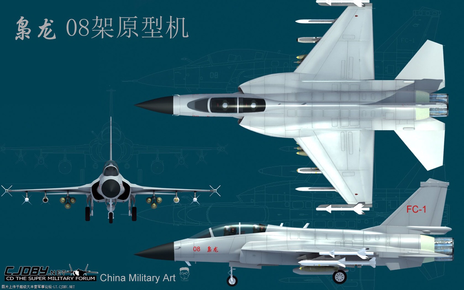

As posted in the Block 3 thread!
Do you have a life outside this obsession "the JF-17 MUST have additional hardpoints"!!???
This is a plain stupid, old, and IMO very much wrong fan made artwork - sometimes I think it was done by you - and I don't know how often you already posted this image? It's annoying and close to the contsant postings of a certain member in the J-20 thread who repeatedly claimed the J-20 already uses a +240kN WS-15.:hitwall:
