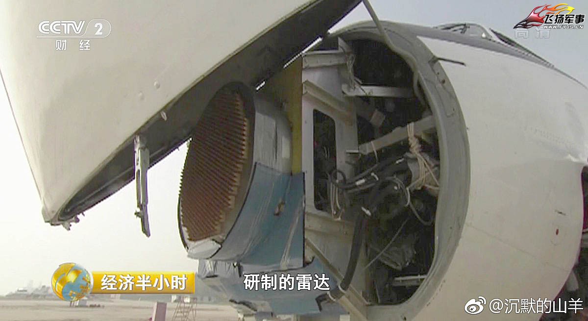

KLJ-7A AESA, estimated T/R modules = 1100
Comparison with other notable Aesa radars..
