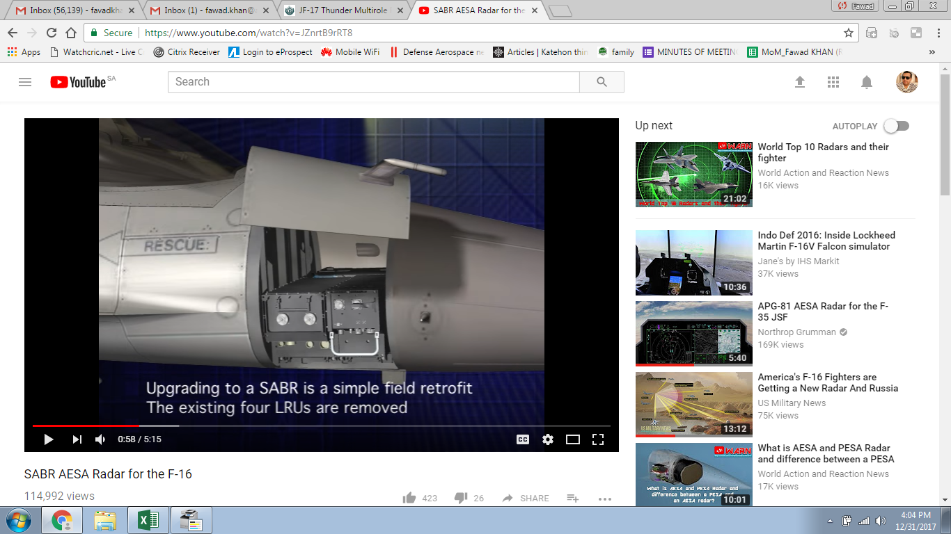

IRST will be plug and play since the concept makes it simpler for earlier blocks to have similar capabilities

Real issue will be installation on 100 examples already produced since it is quite evident that current design both A,B might have issues on fixed in this regard i saw news couple of months back if not years that Chin/ Intake mounted points will be used and frankly it make sense but to do such thing the 100 examples have to undergo some sort of modifications other wise the hardpoints will be used probaby in dual rack configurations

The real question is do we need to upgraxe all existing planes to block 3 standard?. There is mention of aerodynamic consequences needing to be sorted out and balancing issues so why do we need to do so for earlier blocks?
I think the philosophy of not changing blocks was borne out in the 16s as the Cand D variants were different and therefore Aand Bs were not upgraded. I suspect PAF will upgrade what it can but not fully as the changes and lay offs would affect fleet service.

i think US can live with that option since F16 were produced and procured over 4500 so wide range of customer and needs were there in case of JF17 it will be handful around 150 or max 200 (unlikely) so i better have 150 or so examples with intrapolarity and similar capabilities then 50 basic , 50 moderate , 50 advance this makes very complicated for a force i hope my view point is understood ,Im worried for 100 examples but even F16 15 block carries more or less goodies then block 52 other than engine/CFT and some minor modifications , The genius of LM is introducing SABR kit for F16 with plug n play and bolt to bolt
So some thing on these lines should be done for all examples
