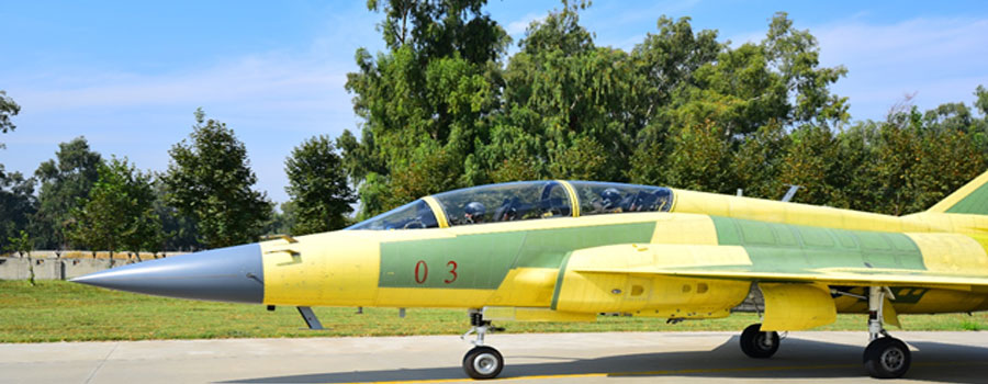

Fuel tanks do exist behind the green "panels".
The access door below the canopy root clearly shows a fuel pipe (yellow) connecting the mid section fuel tank with the fuel tank below the canopy (Pic # 2).
There will be no access doors on green shaded area.
Fuel tanks are vacant sealed cavities where fuel can be stored. Usually other components are not positioned inside these cavities except those related to fuel transfer and fuel flow/level sensors. If data cables, electrical wires are to pass through these tanks, these are insulated inside sealed tubings routed across the fuel tank compartment.
Generally this type of arrangement which we observe on JF-17 can rarely be seen on other aircraft. JF-17 being a small aircraft fitted with most modern packages installed, need smart use of space not only catering space for these components, wires, cables, connecting fuel tubings but also for sufficient amount of fuel to have optimum combat range. Above all of this, aircraft CG (shifting with the fuel consumption) is also being catered
Jf-17 is no doubt a gem model of engineering solutions!!!!!
PS: For those of our respected members who think fuel tanks should not be located on the side of the cockpit, as this arrangement will endanger pilots' safety, I will add here that fuel in these compartments is being used in the initial phase ie taxiing, TO and so on. Complete fuel and its vapours in these compartments can be sucked while transferring the fuel to main tank. Please also note that there are aircraft having fuel tanks located just behind the pilot's seat!!!!.
Pic # 1
Pic # 2
Please do not confuse the issue further. The green panels extend all the way to the front of the aircraft under the HUD. Are you saying fuel is being stored under the HUD?
The opened panel in between mid section fuel compartment and fuel compartment below canopy, shown in Pic # 2 of my previous post, clearly reveals that the connecting tube is connecting mid section fuel tank to the fuel compartment located below the canopy
there is no fuel compartment below the canopy or around cockpit ....
plz try to find pic of cockpit from inside .... you will observe how thin the sides of the cockpit.
HUD is located inside the cockpit. There is no pic revealing green shade (primer) under the HUD. The green shade is visible outside the cockpit module.
Unless you are part of the tech team working or affiliated with JF-17 and wanted to share tech info with us, I will appreciate not to criticise my comments as these are all based on visual and verbal authentic sources available on the net.
Note that location of IFR for both A and B model is always below the canopy slightly forward of engine intake over the green shaded area. We can safely infer that there is a cavity arranged behind the green shaded area to store fuel.
Interestingly there is a push button panel on the green shaded area!!!
Could it house fuel filler cap for ground refuelling???
Pic # 1
Pic # 2
