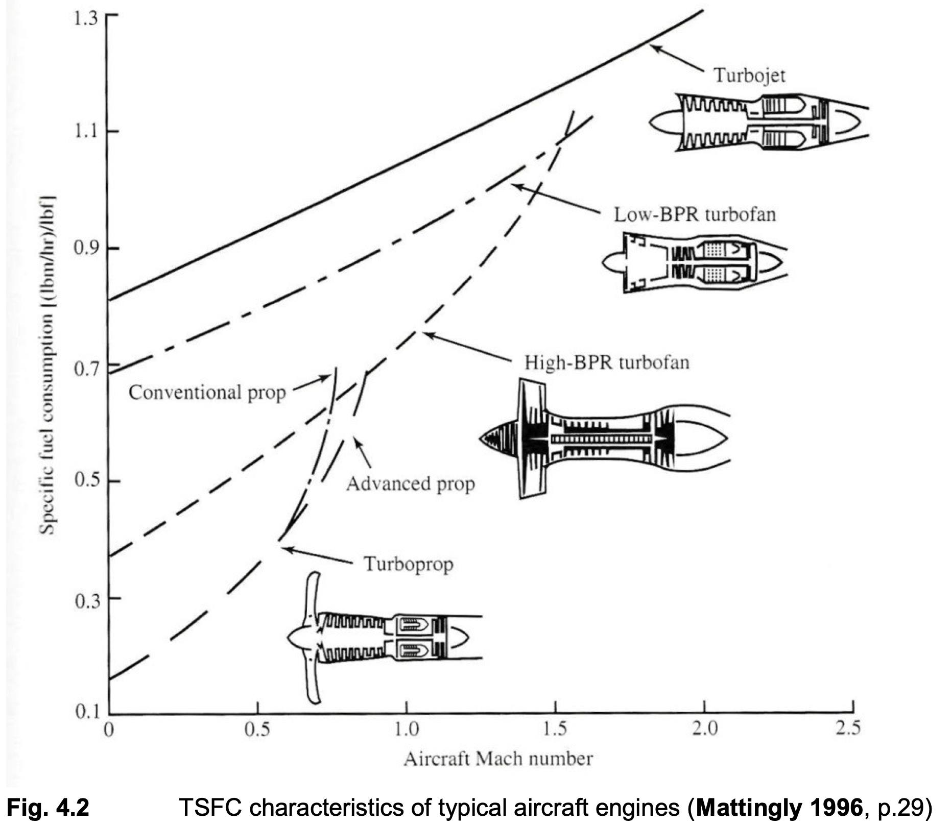

All things being equal higher bypass should lead lower SFC. But the that will come at a cost (relatively) to throttling performance along high altitude and high speed performance.
I see your point, but the relationship of TFSC with aircraft performance is really about the speed with little or no effect on altitude and thrust (in terms of aircraft performance)
Altitude: Over high altitudes, SFC drops anyway due to improved fuel consumption due to differences between the internal engine temperature and outside air.
Thrust: No co-relation of TFSC with thrust since some studies suggest there is less than 1% effect on the TFSC with an increase of thrust.
Speed: TFSC increases with an increase in mach number as per available linear models such as below. However, the increase in the overall thrust of the engine will more or less maintain the high speed characteristics of WS-13 compared to let's say, an RD-93
And some thought the age of innovation in traditional jet engine saga is over.
What I meant was not about SFC. But the impact of altitude and speed on the engine performance. That is, an engine with high bypass ratio will not output optimum thrust at higher altitude and at higher speed compared to a lower bypass ratio engine. Also the throttling will be laggy comparatively.
But as you pointed the difference is not much and as such the impact might be smaller.
