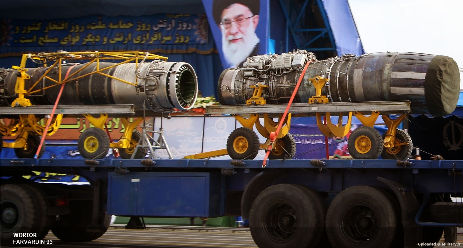

The second engine (on the right) is a Russian RD-33 (Mig 29) ...
http://america.pink/klimov_2456704.html
... or possibly an RD-93 variant (e.g. on JF-17)
http://sajeevpearlj.blogspot.nl/2015/11/russia-ready-to-supply-rd-93-engines-to.html
But I think RD-33. See e.g. s-shaped tubing along front-side, n-shaped tubing along the side near afterburner.
Our DM said another turbojet with higher thrust is under development !
I think he is talking about this :
7pqt4qn-jpg.331960
Actually, it does look like a Tumansky R-11/R-13/WS-13F a lot
R-11 is the engine of early Mig 21s
R-11F-300 (MiG-21F/G 'Fishbed-C') or R-11F2S-300 (MiG-21FL 'Fishbed-C',)
https://www.flickr.com/photos/luca_prioli/5462955576
Tumansky R-13F-300 or R-13F2-300 turbojet engine (later Mig 21, like MiG-21MF 'Fishbed-J')
http://www.comtourist.com/history/polish-aviation-museum/photos-polish-aviation-museum/page/12/
These are of course very similar to WP13F 'copies' used on Chinese J-7s.
But in the above and bolow (top) you see better what it looks like with afterburner attached.
R-11 again
https://www.flickr.com/photos/luca_prioli/5462960402/in/photostream/
WS-13F again
To compare with the unit on the truck, see also here https://www.flickr.com/photos/luca_prioli/5462349723/in/photostream/
I think they are working on a WP13F clone !
