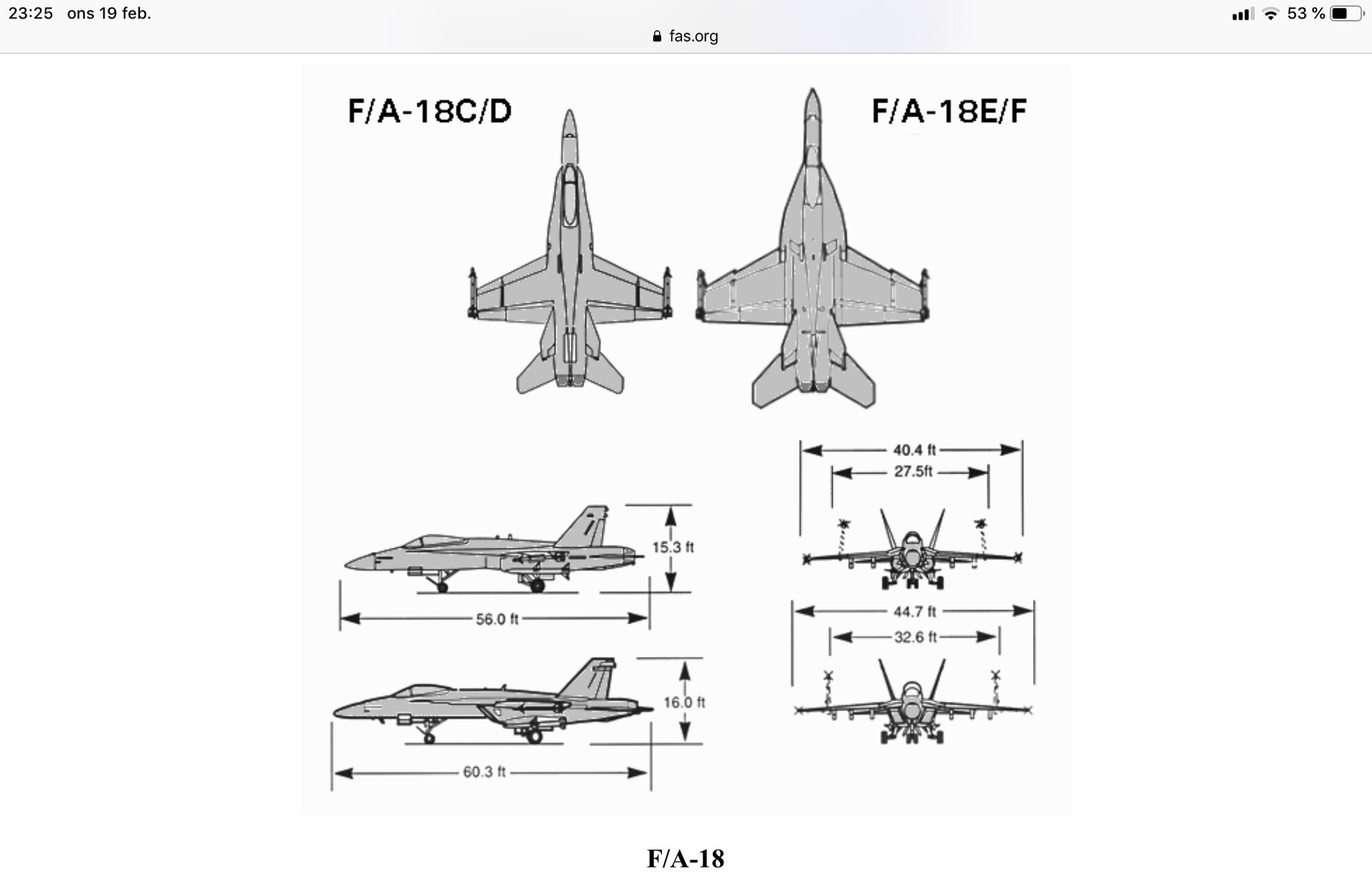

The lifts of the Vikrant are 10x14 meters, and you want a margin of approximately a meter on each side.
The F/A-18E/F has a wingspan of 32,6’ or 9,93 meter giving a margin on each side of 3,5 cm.

INS Vikrant was designed and built for the much smaller MiG-29K and Naval Tejas.
Now the Inidian Navy are in trouble. The Rafale wont fit either since it has folding wings.
Both the Super Hornet and Rafale needs engineering work to fit, or Vikrants elevators need to be enlarged.

The real ‘show stopper’ for the entire MRCBF requirement, however, is the configuration of IAC-1. Unlike Vikramaditya, and like most contemporary carriers, the aircraft lifts on IAC-1 are positioned on the starboard edge of the deck allowing longer aircraft to ‘hang out’ over the water with only their landing gear on the platform. But because the carrier was designed around an air wing of MiG-29Ks and Naval LCAs, the lifts were sized for wingspans no larger than eight metres. 10 x 14 metres, to be precise. While MiG-29Ks and N-LCAs can fit on these lifts with parts of their noses or empennages hanging over the edges, the Super Hornet and Rafale once again cannot.
Both Boeing and Dassault are apparently working on solutions to allow their aircraft to fit the lifts. Sources close to the programme said that Boeing is considering a system that would allow the Super Horner to sit canted on the lift, the tilt of the (folded) wings thereby resulting in a slightly shorter overall span measured parallel to the deck. With its fixed wings, the Rafale cannot offer such a solution, and Dassault is understood to be exploring a detachable wingtip, although this involves greater engineering and certification challenges.
